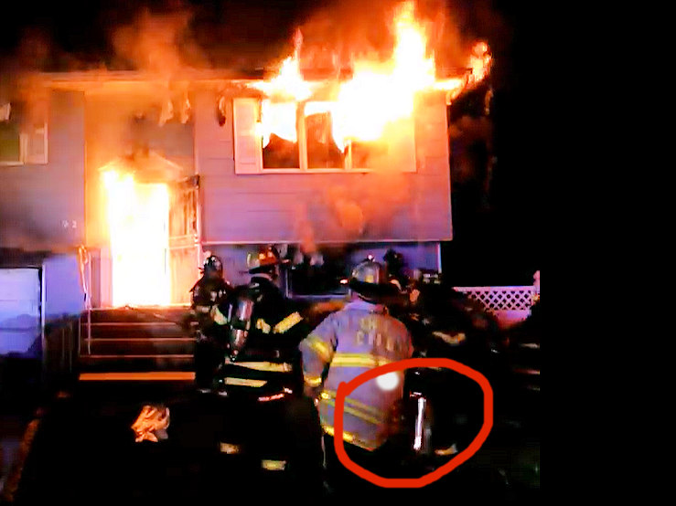

Is that a guy carrying a can at 0:46 into the most recent video posted above?
