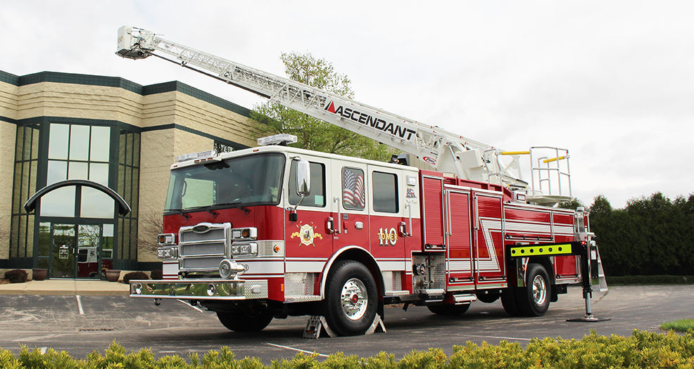

A 110 ft. RM tower with a single set of outriggers, no other stabilization required? Will be interested to see the rating charts.
fdalumnus and x635 like this
Very interesting truck. Definitely a game changer.
I just noticed, amongst many other things, that the waterway nozzle is behind/underneath the bucket. I guess it wouldn't be able to do storefront deluge.
I also wonder what the prices are for this truck are. It must be up there.
vodoly likes this
my concern is the lack of a tandem axle. that much less weight distribution, and less braking. its a new model, some departments will jump on it to be "the first one on the  block." I'll take a flier on it for a couple of years.
The brochure has the outriggers out to 18' and the single jack in the middle rear for the single axle. They also have it on a tandem axle with a 16' spread, but 2 Jack's in the rear.
I was a bit skeptical when the Ascendant was first introduced (as a single axle, 107' stick), but after looking into it I saw that there are definitely department out there that can use it, whether you're in a tight urban district or have a hilly suburban district with narrow roads.  The 110' ladder tower on a single axle has me skeptical at the moment, but I'm sure it would work for some department out there.
COH Bulldog, vodoly, bfd1144 and 1 other like this
I was very interested in the Ascendant when it first came out, after looking at the specs and drawings I realized a few things:
  • While a single axle intially sounds very appealing, the wheelbase of the single axle Ascebdant is actiually longer than most tandem axle ladders.
  • Due to the engineering, the weight allowance for equipment in the compartments is minimal.
  • The ground ladder complement is an abortion for a ladder truck
In my case the Ascendant was not a good fit for a urban career dept, I am sure others have found the Ascendant to be the "end all be all".
AFS1970 likes this
