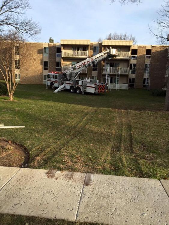

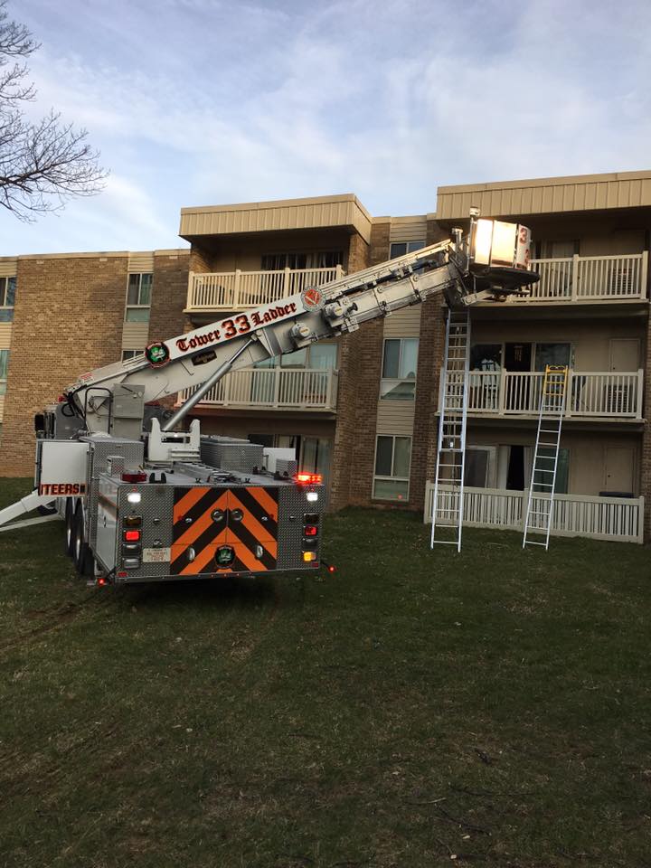

Next, Kentland Fire, in something the "Salty" people seem to have dubbed "beaching" that they displayed on their Facebook page. Now, maybe some more experience Aerialscope operator can enlighten me.
First off, is taking your truck across, what I can only assume is soft soil, and then set it up very close to the building, safe?  I get they had to have been rescuing occupants from the apartment across the hall.
But my question to y'all......and I'm on the fence here.......can you maintain stability in the jacks and outriggers in this type of surface?
I mean, it looks OK, like they got the truck where it needed to be. I can't decide, do I say good job on this one? I want my fellow members to make up my mind please.

Back home we used to "beach" our quint ALL the time (1999 RD Murray pictured below).  I cannot speak for AerialScope, but if you need to place a ladder in a specific spot, go for it.  You can always call for a wrecker to pull the rig out of the mud (and our quint got stuck quite a few times).  From what I've witnessed, soft terrain was never an issue for stabilizing the truck.  The outriggers just compact the ground below with the use of 3X3' steel pads.
With that said let me explain why we always "beached" this truck.  The village has wide streets, and every house is 50' or more from the roadway centerline.  By "beaching" the quint we always guaranteed the ladder in the front (the quint was first due any way), and also got the turntable underneath or past the power lines above.  The village is well hydranted, so water supply was never an issue as the first due.  But the front yards of burning homes was the quint's spot.

The video and the still shots don't really give enough information regarding the placement of the truck in relation to the active fire.  Generally speaking I was taught never to take my apparatus off hard
pavement (specialized vehicles notwithstanding).
Although they have their outriggers extended, they do not appear to be on anything other than the grass surface.  If they were extending the bucket any further than what appears in the still photo they
could be risking the stability of their working platform. Did they really need a bucket to effect these evacuations or could ground ladders not have accomplished the same in maybe shorter time.
As always, its a judgement call made in a matter of seconds.  Since rescues were accomplished and the apparatus was not damaged, its a win, this time.
I remember a grass fire I responded to.  Kept my CF Mack on the hard road. Our new mini-pumper came in, left the road to cross the field and promptly sank up to its axles.  You take your chances when you leave the road.
My Monday morning QB instinct says I'd do it but prefer the truck back in, in case it got stuck you could use the aerial without going over the cab. Pretty common to see pics from PG county with truck off the pavement, not seen any that had poor results? It's always tough to argue against a positive outcome, easier to cast stones when it's a negative.

Based on their proximity to the building they took some measures to reduce the side loading on the outriggers by keeping the ladder retracted.  Best option would have been backing in, this is probably the second best assuming they had good distance from the active fire.
