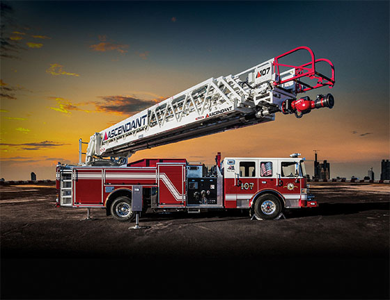

Behold the new Ascendant 107’ steel aerial ladder from Pierce. With 107’ vertical height and 100’ horizontal reach on a single rear axle, it’s brilliantly designed and engineered to give you more capabilities with no sacrifice in water capacity, performance or safety. You refuse to compromise. And so do we.post-11-0-95001400-1429829156.jpg

Interesting but I think I'll reserve judgement for a bit. 100 ft HD on single axle with pump and tank is a feat in itself, but the jack stance shown shows one set of outriggers and a down jack to the rear of the torque box? Innovative? Maybe, but those things that seem to good to be true, often are. What does lifting the torque box and rear of the truck do to the frame and suspension forward of the outriggers? Seems like a lot of weight being transferred to the front axle and suspension, I'd worry about long-term costs. Then again, maybe the outriggers are forward enough to minimize this? But wouldn't there be a stress point between those jacks and the cab?

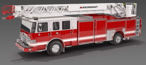

While I agree with making it a truck. Removing the water and pump wont change its height. On a rear mount, that's dictated by the cab and rail height.
We bought a rear mount ladder with no tank or pump 2 years ago. We had a max height of 11' 2" and Peirce told us they can't build that low in a rear mount.

All Pretty standard except:
Equipment
2500 lb - " This wont take long to exceed "
Specifications
Custom Chassis Choices
Arrow XT™, Enforcer™, Impel® or Velocity®
Engine
Detroit Diesel DD13, Cummins ISX 12 or ISL
Tank
500 gallons
Stabilizers
Single set of outriggers & one downrigger
Jack Spread
18’ / 13’ short-jacked
Rear Axle Suspension
Single
Equipment
2500 lb
Overall Apparatus Length
39'2"
Overall Apparatus Height
11'5"
Collision Avoidance
Standard
Multiplexed
Yes
Read the fine print.....
Stay Safe.
