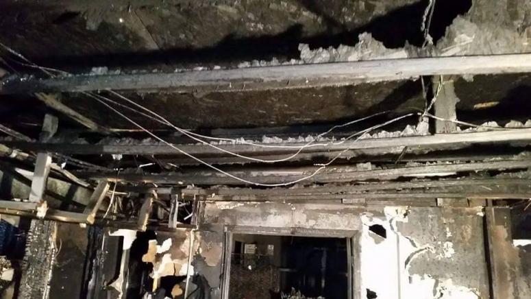

(The 1st Photo shows extensive Basement Damage to a residential fire In which the "Engineered strandboard I beams" burned 87% away and are sagging in the photo,)
"This is a photo from the basement of the House Fire today. Notice the burnt out I-beams. These are the engineered beams that are common in construction over the last few years. The floor in the living area above had sagged about a foot and was on the verge of collapse when noticed by interior Officers and crews. Fortunately no one was injured and the area was cordoned off. Just another reminder of what can and will kill us. Thanks to Mark Kaufmann for sharing the photo."

From the picture, it looks like the 2x stock portion of the wood I beams didn't even char very much. I can't tell from the black and white pic if the OSB portion is burned away or disintegrated from being soaked in water. Either way, the hazard is obvious and severe.
when YOU look at the underside of the floor sheathing The fact that the UPPER thread (2x4) is GONE and Look the further right the More (OSB) strand board material is remaining... Obvioulsy I am looking at the same photo as will everyone.. this fire Burned through the strand materialand the Upper 2x either fully burned or fell to the floor level Point is this is "about 2 seconds" from collapsing and killing firefighters and or residents.... the Lower picture is of similar OSB i beams before the upper level platform has been place (not the walls are 2x6 on that larger most likely a condo complex or commercial building , BUT the I BEAMS are the concern here....
its suggested 6 minutes burn time] and I don't "KNOW" but I suspect the lower 2x4 may have been protected By wallboard but again I don't know this..... OSB or strandboard was designed to be Wall sheathing just as "particle board" was designed to be an Underlayment, its amazing how the industry has Pushed and pushed and pushed

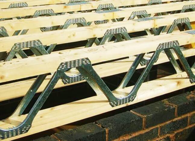

I am not here To argue , I am retired so Its No a big deal To me ...But a brother Posted The Photo below along with the Name of the Company ("Wolf Systems, UK") who began the Interior Strandboard Stairwells and is now Looking to do These Super/Ultra Lightweight Trusses.......
"FETC Services on Facebook suggests Taking a Look at these ultra lights Euro approved
Check out these new ULTRA LIGHTWEIGHT ENGINEERED beams. Coming soon to a floor, a ceiling, or roof rafter near you!! I think we all understand that lightweightconstruction burns faster and lightweight structures fall down quicker... less mass simply jeopardizes firefighter safety under fire! So keep your eyes open for new construction in your area and monitor what contractors are using!
These are from Wolf Systems, UK . You also find pictures of the lightweight stairs, that we previously posted on their website. FETC Services."
company website
https://www.wolfsystem.co.uk/products/easi-joist.aspx
