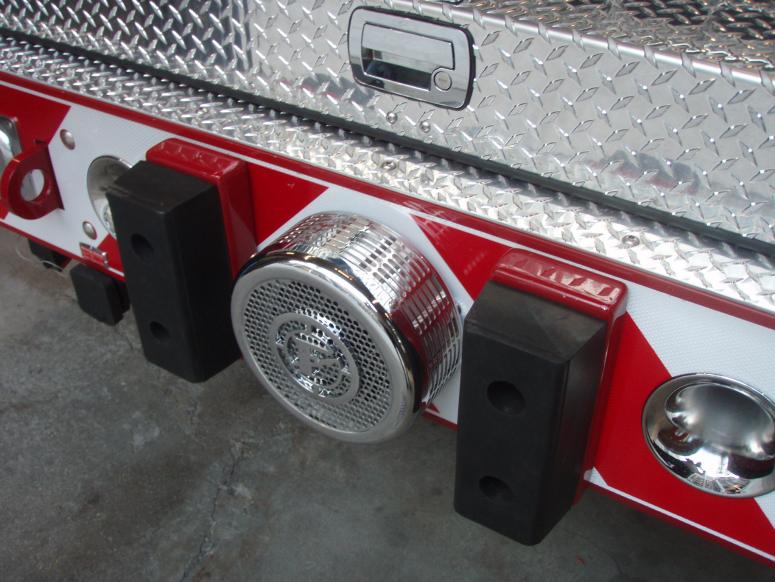

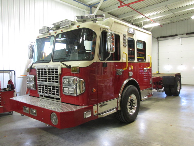

Does the mounting of the siren make a difference?
So lets compare.
In the 1st picture the Q2 is completely recessed in the bumper. This provides good protection for the siren, but since the majority of the sound comes from the side not the front, the sound is directed under the bumper and into the cab. Also this design defeats the strongest bumper by cutting such a big hole in it. This reduces the crashworthiness of the cab.
In the 2nd pic. its mounted above the bumper, less protection for the siren, but the sound is pushed forward of the cab more than other arraignments.
In the 3rd pic a shroud is added, this forces more of the sound forward away from the cab
In pic 4 the siren is only partially recessed allowing the sound to travel, but the siren is more vulnerable to damage. The addition of crash protection protects it, but does reduce some of the effectiveness of the siren.
Every item on a rig is a compromise. One needs to evaluate the pros and cons of each of these

I agree with SECTMB. Every dept that i have seen or involved with uses headsets. It is no secret that the siren, horn and all other noise around us has a direct impact on hearing. The Federal Q is the strongest and loudest siren made. So yes photo 4 is the simplest way to direct the noise forward. Thats what you want anyways. So to sue instead of using headsets that is if Buffalo is not what a chicken s#$@ move. My left ear is diffently weaker than my right. What a concept!! So if the F/F choose not to wear headsets then its their own fault. They have a choice.
Barry, would this design seem the most fitting for a Q? In my mind it seems like a great design, forcing the sound waves forward, especially since you are trying to warn traffic AHEAD of you that emergency apparatus is coming. Plus, the directional push of the siren may help with aiding civilian drivers of which way the siren is coming from (speculation since I've never really looked into studies on this type of thing).
Now I want to pose another question...What about electric Q's? The speaker is facing forward, away from the cab, and can achieve the same effectiveness as the good-old-standard. PLUS, the decibel level of an electric siren tends to be less of a mechanical siren. Thoughts??
My bad, i meant the 3rd pic. I have seen studys on sirens. Even though it has been a few years. The electronic siren are better heard from the side or rear. As for a mechanical Q its sound fills all around. Plus it is much louder then a electronic siren. I wish i still had the report so i could share and explain in more detail. Example on a electric siren... Has anyone noticed or seen a speaker at a 45% angle? They are trying to have the sound move ahead and not to the side or rear. And electronic siren is a electronic siren no matter what sound comes out of the speaker.
