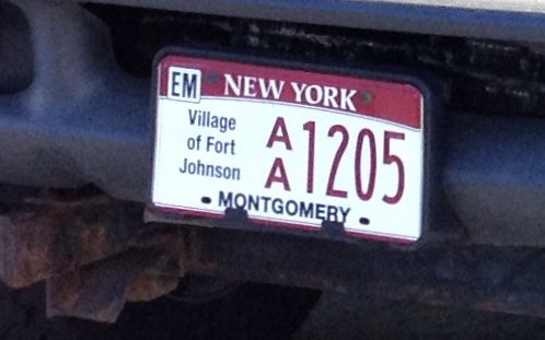

I'll try to snap pics of new ones as I see them.

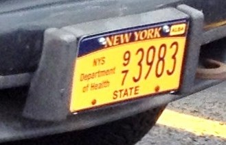

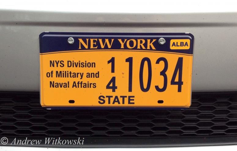

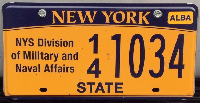

These are the new plates btw. Except they won't say STATE and name in the right top corner will be the county.

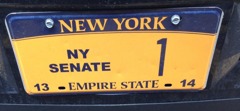

Every municipal vehicle are getting the new plates, so every vehicle that belongs to a municipality or the state will have a gold plate with which department/agency the vehicle belongs too.
