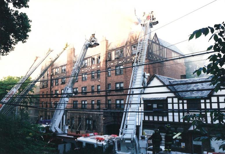

Okay. Everybody SLOW down.
Yes, the truck SHOULD get the front. Especially in a response district like that one.
I don't work in Yonkers. Not even close. There is ZERO need for a tower ladder when fighting a fire in a single story ranch on five acres at the end of a 200 foot driveway. My engine has ladders that will reach the roof. (Not that you really need to cut a whole in that kinda of structure, anyway). It has saws, hooks, fans. What exactly do I need a truck for? Just cause? No. I'll take the 1000 gallons of water, thank you.
What I'm getting at is you adjust your tactics for your situation. Manpower, types of structural issues you have, water supply. Ever heard of coal was wealth, Wallace was hot? All them things? Am I advocating for not having truck companies in Yonkers? God no.
I am saying that there are no golden rules. We adjust, adapt and improvise to overcome the obstacles and challenges we face. One of those adaptions we make is to sometimes leave the tower in the barn and take the engine to fight the fire. Water on the engine puts out fire. Dry trucks don't. If you had to pick one or the other, which would you choose?
