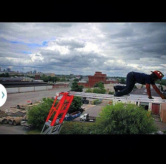

Thoughts? This had got to be Photoshopped.
Credit to the anonymous Twitter user who posted this
It's real, I know who the gentleman is who took the photo, it's taken today from Louisville KY, they also did the "church raise" or what ever each area of the country calls it with the 50' extension and stay poles.
From a person who has been in and around the fire service for the 28 Years, I can not think of any reason to do this.
Even if you used webbing to tie off the the end on the ladder, this is NUTS!!!
Come on, This is a NIOSH report waiting to happen.

The amount of movement that even a modern aerial has far exceeds the overhang buffer that the ground ladder has either to the top of the parapit or to the tip of the stick. The guy has no climbing harness or other PPE to support this type of adventure either. Even if you could tie it off the chances of failure for this system seem high but I'm unfamiliar with its use. I'd cut the tree down and put the stick up to the building if it was a legitimate job requiring roof access.
It's just plain stupid this is why our trade has gotten into trouble.
Have seen this floating around on various social media sites today as well. From what I can gather the picture is as stated from a Louisville, KY probie class and is called the ladder bridge. It sounds like it is also practiced in Detroit as well. Some photos of rescues from Detroit, FDNY, and South Florida have also surfaced with some variation of a ladder, anywhere from a 50 foot extension to a short roof ladder, added to the aerial in some variation for extra reach.

This tactic does seem risky and I really cannot think of any practical use for it. That said, if I had to think outside the box and rig this contraption together in an effort to save my own life or rescue a fallen firefighter, then I'd climb across it. It can be done...it shouldn't be done...but it can be done...
Now comes the double-edged sword...If it can be done, do you practice the tactic so that firefighters know this is feasible even though it is not recommended? Or is it too dangerous to even train on this tactic? I probably would have thrown a safety line on the guy at the bare minimum if it were me running the training! God forbid one of these guys gets hurt while practicing it though...lawsuit waiting to happen!
I see your point of view regarding "if you had to... you could".... But this seems too risky to train on for me. No harness, not tied off, and you are putting a level of stress on the ladder that it wasn't designed to hold. I'm not an expert on ground ladder capacities and testing, but the strength of the ground ladder is dependent on much of the force being transmitted down to the ground. In this case 100% of the force is being transmitted the opposite way.... The exact same way that aerial devices typically fail.

I agree, would like to see a belay from a high point. From what I ascertained from comments on people that were there, the roof ladder is tied off to the aerial. No mention on what the other side was going to, what and how far is anything below, if there are any passive fall protection. Would definitely be interested in knowing the ladders, both aerial and roof, capabilities used in this manner. Having witnessed ground ladder testing this is the same way that they are set up with a horizontal load placed in the center. Its actually pretty violent to watch and I'm not sure I gain or lose confidence every time that I watch the annual inspections.
I am just guessing looking at the one picture but here are some thoughts on this bridge.
Even tied off to the aerial, that tie off would seem to make a hinge point. That means if the aerial shifts at all the ground ladder risks falling. By nature it would have to be this way at least until the first FF makes it across to tie it off on the building somewhere. As for a belay point, it seems like the only application for this would be somewhere where there is no higher point to tie off to. Harnesses and fall arrest systems seem like they would be of limited use until both ends of the ladder are secure. Even after being secure, a catastrophic failure would likely be in the middle and would thus leave the ground ladder hanging by its tie offs and dropping the FF a good distance before the fall arrest device would kick in.
As for the training issue, I think the only way to train for a tactic like this would be with a prop made of an old fly section and put only a few feet off the ground. Perhaps only tall enough to allow standing on the fly to tie off the ground ladder. Not perfect but safe®. I am reminded of the scene from Bridge on the River Kwai where they decide not do do a practice jump because the chances of injury go up with each jump. Thus they decide it will be better for the paratrooper to make his first actual jump on the mission to blow up the bridge. The paratrooper was trained on ground based props only before the mission.
So we always hear about this thing called a risk benefit analysis. Apparently most people don't know what it is or don't do them. You should be doing it in your head quickly all the time.
So is this risk worth the benefit?

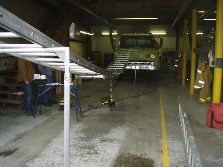

You may want to look at what a UL inspector would do if he was asked to do the annual ladder test on that Arial, after seeing this picture. The ones I have spoken with have said if you use it beyond its designed limit, they will de-certify it.

I'm in agreement with your overall view, but with regard to the original post photo I think the risk is too great, as the real "reward" is merely a confidence measure. Many of us have done things beyond our training, some more often than others, but there will always be that time that a little more length is needed, you need to crawl that much further, the heat is just above what most would consider safe to endure. These one-offs will always exist and we will never be able to train everyone for every eventuality. What we can do is train beyond the everyday routine to ensure we're ready, but we do owe it to our families and the families of those who work for us to not accept undo risk when the reward is not directly in front of us.
The only thing that picture proves to me is that some people will do anything they're told. Does anyone believe the rest of the fire service that doesn't take part in this kind of "confidence testing" really all "Sally's"? There is something to be said for a person who has enough presence of mind, self-confidence and sense to hesitate and question some orders, not all of us are 100% right 100% of the time.
Wow, good to know Captain. When you say designed limit do you mean weight or intended use? Always wondered if the way FDNY and other departments used their aerials to take windows voids any warranty or like you stated decertified the ladder.

1) Wow, good to know Captain. When you say designed limit do you mean weight or intended use? Always wondered if the way FDNY and other departments used their aerials to take windows voids any warranty or like you stated decertified the ladder.

1) More about force than weight. Was it designed to have force in that direction? A number of ladder failures in the past were when one side was against the building and the other was not, as you crawl out does the weigh shift multiply because of the "level" you have created?

Re: The Ladder Bridge: Bridging with a ground ladder was an acceptable practice for many years but I think that aerial-to-roof bridge is stretching the safety limits way too far. If you want to train on it (for that day you may have to use it), Why not do your risk/benefit calculation and come up with something with a little more common sense for training. How about aerial-to-3rd Floor Window instead of aerial-to-roof. From above add a belay line to a harness on the Firefighter. If you can find a tall building that abuts a shorter building, even better.
