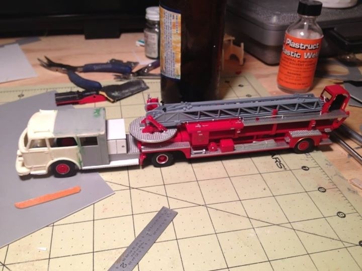

Coming along nicely. Next step is to break down the trailer and put in the compartments.

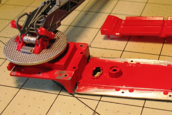

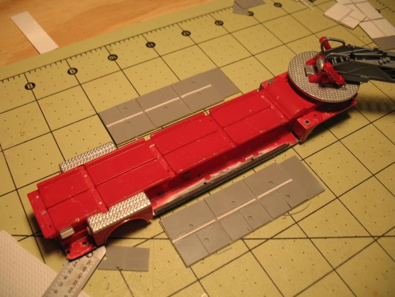

Started the trailer modifications. VERY difficult disassembly, and I still haven't figured out how to detach the ladder and turntable.

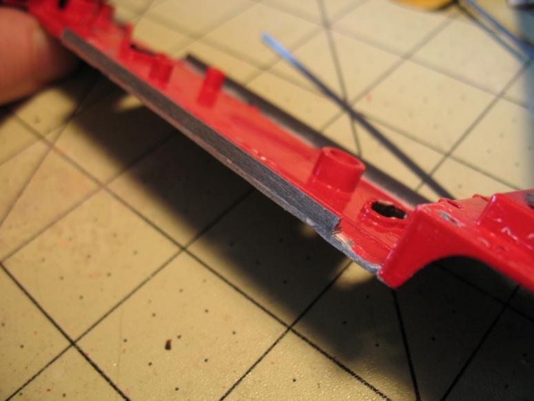

Once I stripped it down to the base plate, I used a Dremel to grind it back about 1/16" on each side so that the new side panels for the compartments will be flush with the existing fenders.

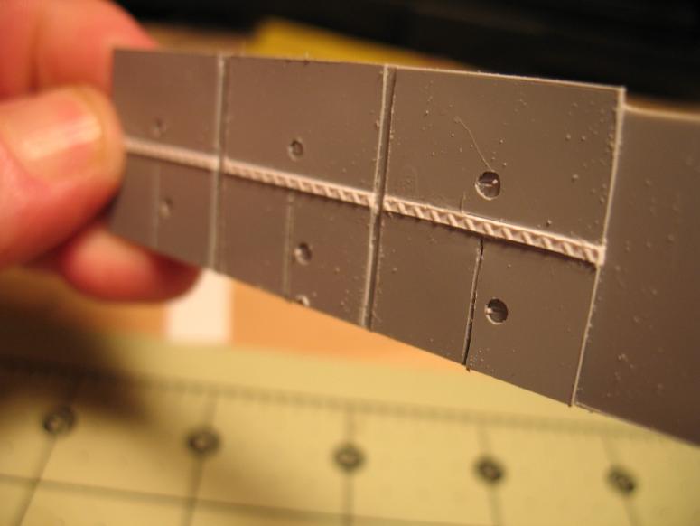

Next, I measured for the length of the high side compartments, leaving a space behind the front fender, which is where the rear hydraulic outriggers wold retract into, did some arithmetic, and marked out the panels. I used .02 ABS sheet for a base layer, and .01 ABS on top of that for the panel doors. Then I ran a strip of DP between the uppers and lowers. Each compartment was a separate unit on the actual truck, so I scribed a deep line between each section. Later, after it's painted, I will use a black wash to highlight the low spots.

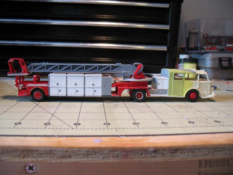

I had to start the cabinets all over again. The completed assembly was too short. This time, I used .005 styrene overlaid on .02 ABS, then sanded it out. I want this rig to look "beat up" rather than factory fresh, and I remember the real one was practically falling apart by the time it was retired. It, and its two sisters, were worked very hard during a time when Yonkers was broke.
Anyway, I made a lot of headway on the trailer. The tillermans's gondola needs some work, these rigs had open ground ladder cribs rather than the continuous deck on the Code 3 version.
