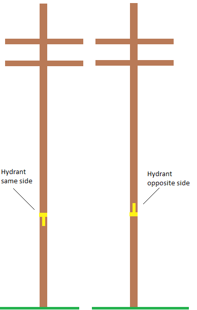

These devices are good, but prone to damage from vandalism and lack of maintenance. I've seen more than a few damaged by heavy snow thrown by plows. Years ago we used to use a system where we painted a reflective yellow ring about 6" wide on the telephone poles on either side of the hydrant at eye level when driving the rigs (roughly 6-7 ft from the ground). As you turned into a street and approached the incident you would look at the telephone poles. If the hydrant was on the same side of the street as the poles a line was painted on each pole facing downward from the ring, if it was on the opposite side the line faced upwards and if the hydrant lie in between poles that crossed the street the line was placed on each pole in the appropriate direction of the approach. Many of the markings are still visible and we are planning to redo them once spring arrives.
The benefit of this simple system is that snow, even plowed snow piles, bushes, trees and parked cars rarely if ever obscure the markings and maintenance is nothing more than a few hours and the cost of a gallon of paint to touch up the markings every few of years.
Below is a rough (really rough) drawing to illustrate:
