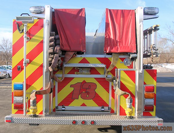

I really like this idea. Takes a lot of the effort and danger of climbing over a hose bed to pack hose away. What does everyone else think?
If you feel you can spare having the extra hose, sure.
If you have space to spare like that, you spec'd the rig poorly. I can't say I agree with it being all too difficult to simply stand or kneel on one hose load to pack another.

I agree. there is a reason just about every fire dept engine company carries about the same amount of LDH and attack lines. You just never know what you need and when you will need it.
Honestly I'd be worried about back injuries trying to pack hose in there.... You'd be standing without the ability to bend at the knees and dragging hose using nothing but your lower back as motive power... I'd rather have another few hundred feet and kneel to pack hose.

Agreed. This is nothing more than a waste of space. Sometimes making thing "easier" or "safer" makes them less useful too when put into practice.
Right with you. I can't imagine how this makes packing hose easier. I see more injuries.
Anyone note the load? With so little hose how about just dropping the divider heights and make wide low loads. With narrow tall packed loads the guy standing on the back step still is loading over his head. By lowering the loads its safer for more than just one guy. Plus if they are stretching off the back step easier for the nozzle FF.
Also is that a walkway or just a currently unoccupied section of hose bed? The hose is not or not entirely pre-connected so just maybe currently vacant storage

One of the main things I think about when an engine company is designed is the hose bed. Our dept uses the rear or business end of the apparatus 99% of the time. I am much more concerned about getting the hose off rather than packing it, IE: low workable hose bed. I can take all day to repack the hose.

We had 2 of our engines with the walkway, it had advantages and disadvantages and the main disadvantage was like posted elsewhere, it was tough on the back packing hose especially as you get on in years. I for 1 am glad we don't have those rigs anymore for that reason only, but I sure do miss those 2 MACKS (1962 & 1984).

My Department had many Engines like this up until 1990. It was a popular feature in Volunteer Departments in the North East especially on Mack trucks. Believe it or not back in the day the "bench seats" above the hose beds were usually filled with many bodies gearing up!

Our 62 MACK was actually copied from a long island rig and yes it had seats, 4 cushioned seats that opened up to pack hose. When we were writing specs for our 84 MACK we could not call them seats we had to call them doors, if they were "seats" we would have had tohave seat belts. We actually had a door installed on the rear of the walkway to make use of the space under the walkway.
Also, lower hose loads lowers the center of gravity of the vehicle (albeit by not much) to make the vehicle easier/safer to drive.
Generally, the lower hose bed is created by making the horizontal water tank a vertical tank (in front of the hose bed) and their is no change in the center of gravity as you have moved some of the water up into the space that use to be occupied by hose.
