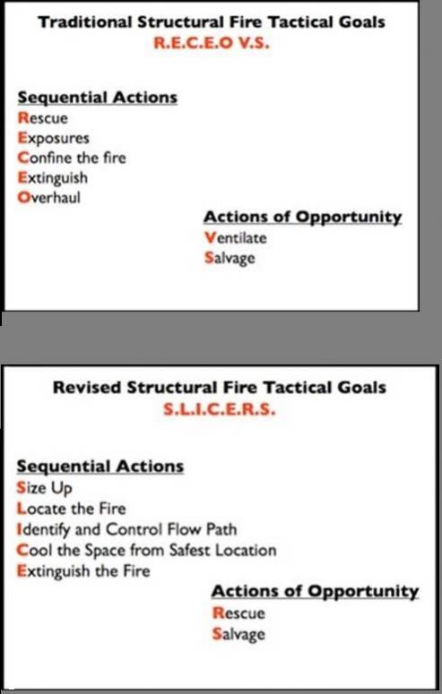

Here's a brief outline of "old" vs "new" tactical objectives for anyone interested, for my part I'll stick with the old:
Edited by FFPCogs
