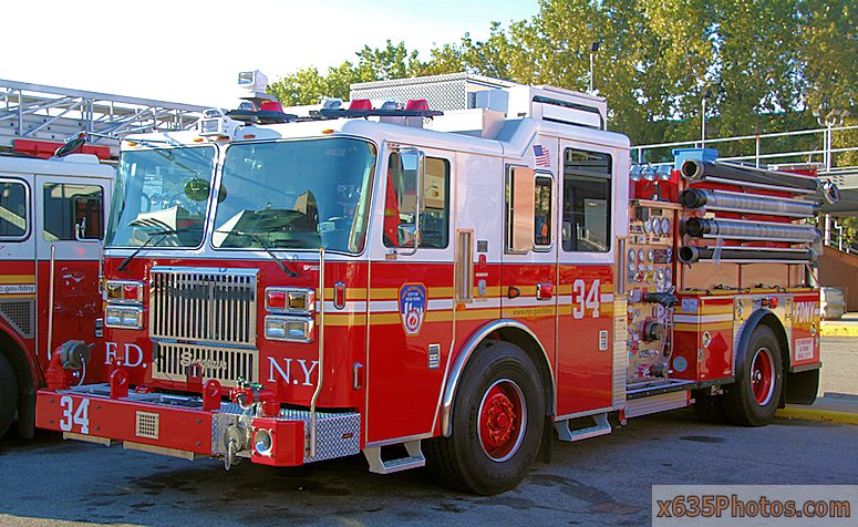

Nice Engine Co. But i wonder why FDNY went back to old school rorators on the light bar?
Not "old school"... Those are the new Federal Signal LED rotators, Vision SLR. A rotating mirror over a field of LEDs.
http://www.fedsig.com/products/296/vision_slr_lightbar
This seems to be the new standard lightbar for FDNY and NYPD on new bids. I cannot tell you why other than someone put it in the specs.
Edited by lalautze
EmsFirePolice likes this
the rotators tend to bounce off of buildings making it easier to see a rig before it comes around the corner whereas leds aren't as effective until they are up close

no blue to the rear?
Maybe in the rear minibars, I know blue is spec'd for new apparatus now, but you're right, can't tell if there is or not.
Well, The vision SLR are not very bright. Should of stayed with Whelen. Thanks for the answer though.

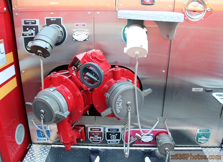

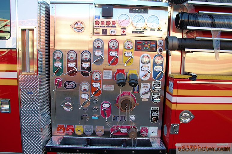

The passenger side pump inlet layout is interesting. Is there a valve that allows the ECC to choose which intake he is working with?

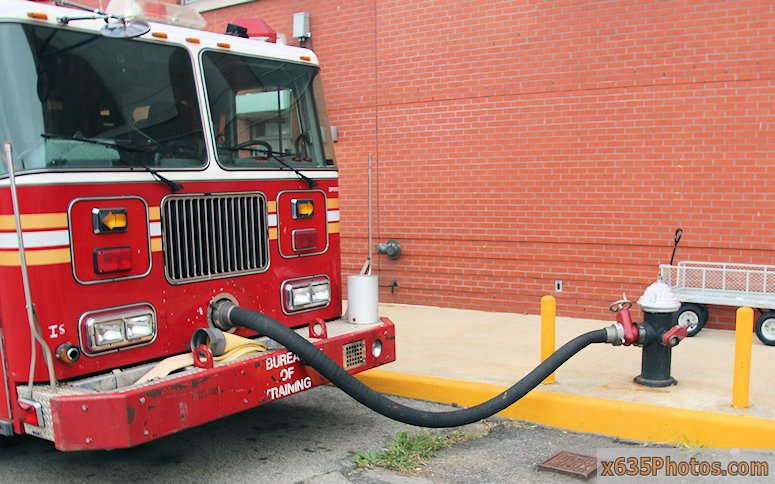

Questions for the knowledgeable folks:
-There are 4 sections of hard suction, what is the smaller diameter one use for?
-When the HP pump is in use, does the chauffeur use the side or rear discharge?
-What are oval gauge the underneath the circular gauges?
Also not another lightbar question but, does anyone know why they went away from the Aerodynic lightbars? Wonder if it was cheaper to buy the same lightbars as NYPD.

The oval gauges actually are to display the position of the valve to let the operator know if it is open, closed, or where in between those positions. Most of the valves are hand crank operated not a lever.

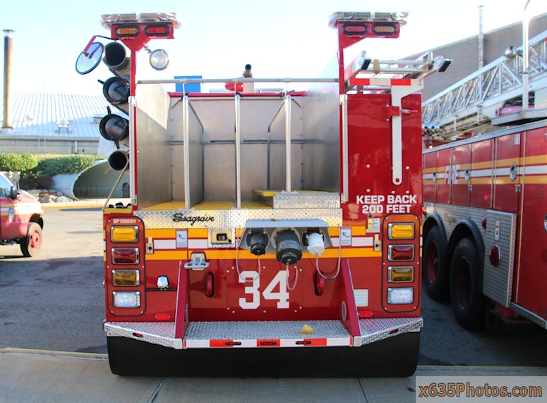

An FYI for anyone who hasn't been up close to an FDNY rig. Look at picture number three ( the Chauffer side pump panel) the compartment to the right of the panel. Check out the carabiner (lock) on the door. The "D" (the round handle) handle does not turn, if this is the same as what I had seen on Rescue 5 when it was at the Long Island Show two years ago (?). You do not have to turn the "D" ring, just pull the door open, interesting concept.
Questions for the knowledgeable folks: -There are 4 sections of hard suction, what is the smaller diameter one use for? -When the HP pump is in use, does the chauffeur use the side or rear discharge? -What are oval gauge the underneath the circular gauges? Also not another lightbar question but, does anyone know why they went away from the Aerodynic lightbars? Wonder if it was cheaper to buy the same lightbars as NYPD. Thanks.
Not knowing the specifics of the FDNY rigs, but from seeing pictures of how they operate, the hard suction line in the bottom rack (smaller one) looks to be of heavier construction and is most probably used for hydrant operations. The other three look to be of the lighter construction and are used for drafting operations. Being a long time Engine Company member and Officer, this is what I have seen over the the years. The lighter ones typically would not be able to withstand some of the higher pressures from hydrants, whereas drafting operations would create a negative pressure within the hose.
Yes, there is a valve.

I'll answer your questions in the order you've got listed.
1. The top three are flexible hard suction, for drafting. That's why they're stored higher up, in the less accessible position. The bottom, smaller length isn't really suction. We CALL it soft suction, but it isn't rigid. It's is our go to hydrant connection, at least here in the Bronx and the areas of Manhattan I'm familiar with. It's 10' long and is flexible and foldable. It's easy and quick for the engine chauffeur to hook up alone. Once the hydrant is open, that 4" diameter length will expand to maintain its shape regardless of how it's bent.
2. During high pressure ops, the chauffeur will use either the officer side discharge or the rear, whichever is more conducive to stretching to the Siamese. Never on the panel side, there is no HP discharge there.
3. This was answered, but again, it's just a meter showing the position of the valve. I find them to be useless. What does it matter what position the valve is in? You have the pressure gauge and the flow meter and the numbers they show are what determine whether you have to gate down or open up......or up the master on the pro-pressure governor.
Nope, standard door knob requiring a 90* turn. The carabiner is just an extra safety measure to guard against leaving the knob in the open position.
Actually, while the drafting hose might look lighter, it's actually very heavy duty. The negative pressure it has to with withstand is tremendous, far more taxing than hydrant pressure. Hydrant pressure in the city ranges from 55psi in most places to 100psi in Staten Island (+/-). The 4" hydrant connection at the bottom could never withstand the vacuum effect of drafting operations.

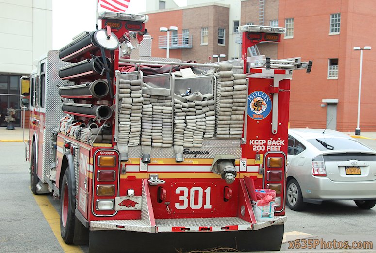

M'ave, thanks for the information. I have a question, not geared to this particular rig. FDNY hose beds have always intrigued me. What is the standard hose load on a FDNY engine ? Does it change from Boro to Boro ? the tanks are L shaped, are they all 500 gallons ?
The Regs do establish a standard compliment of hose and some modifications for winter operations. The Regs stipulate a total amount that must be carried, but companies do make modifications based on their response area. A standard hose bed might consist of the following:
2 beds are the same: 6 lengths of 1-3/4" on top of 10 lengths of 2-1/2". This gives you 2 16-length attack beds. More than 6 lengths of 1-3/4" is not permitted.
1 bed of 2-1/2" , 10 or 12 lengths. Attack line for commercial fires.
1 bed of 3-12", usually 10 lengths. This might be used to relay to another engine, supply a tower ladder or multi-versal or to inline pump from a hydrant.
3 lengths of 2-1/2" are kept as "roll-ups" for standpipe operations and are stored on the ledge below the suction on the chauffeurs side. One additional "roll-up" is stored in a compartment.
All engines have 500gal of water. (There might be some exceptions in remote parts of Staten Island where companies have 750gal tanks, but I'm not 100%)
Hope I'm giving the right visual to help out your awesome description....
Nice shots. That's it to a T. The gate on the 4" outlet we don't use, but when give permits, we try to put on the 2-1/2" gate. That allows the chauffer to self augment if necessary. The front intake is great for flexibility, but we usually try for the side inlets, that keeps the rig out of the road, allowing other rigs to pass, like a TL.
