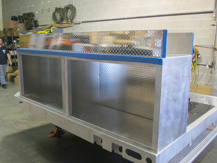

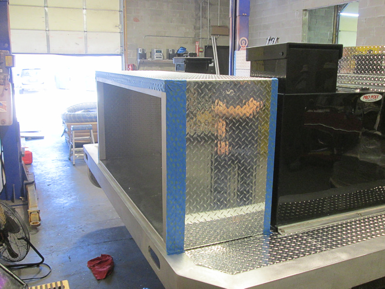

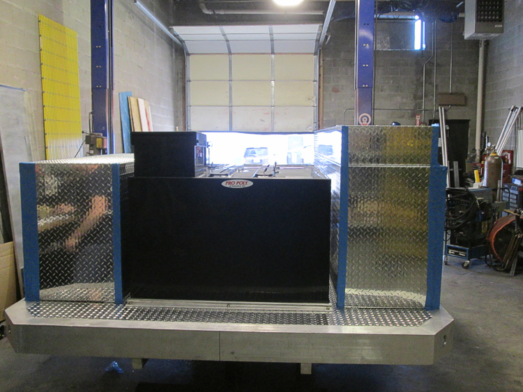

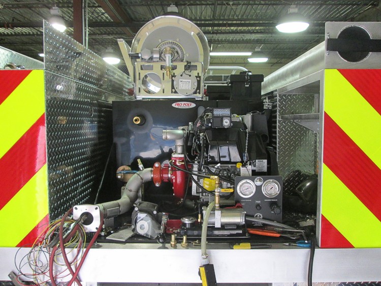

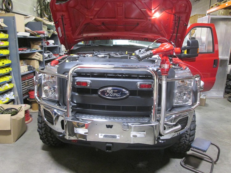

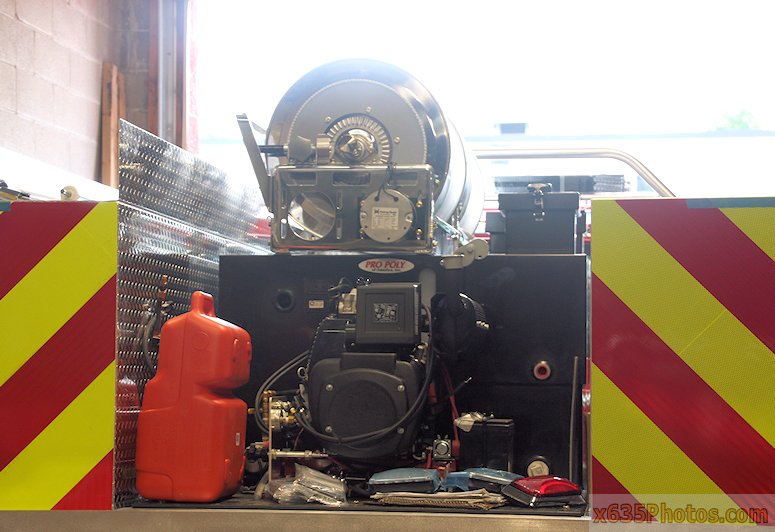

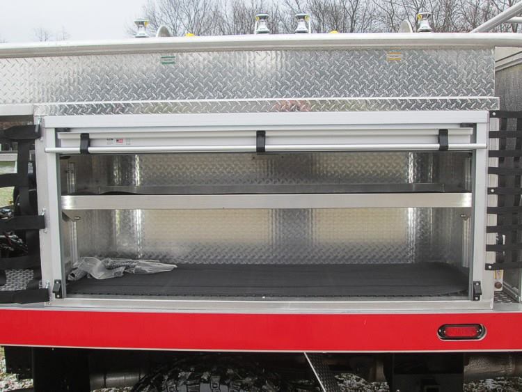

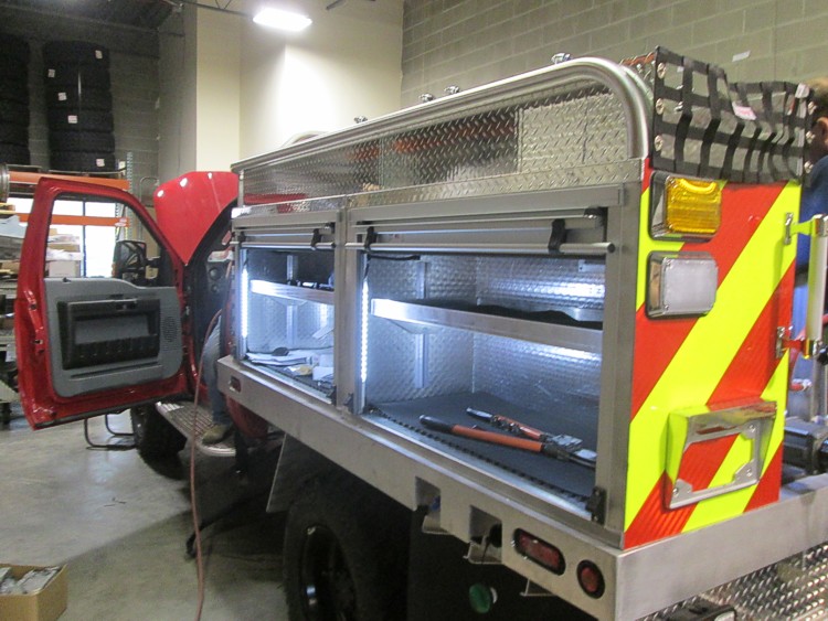

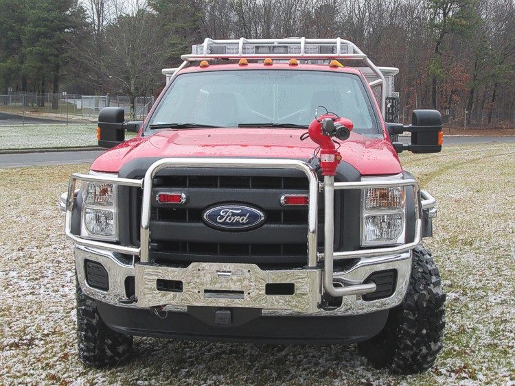

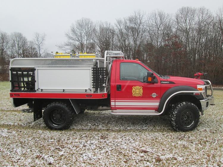

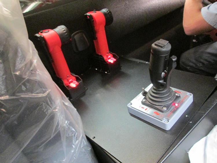

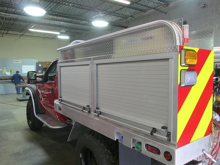

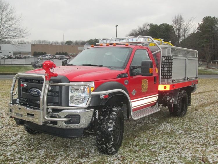

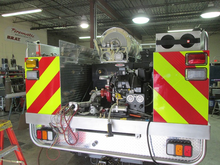

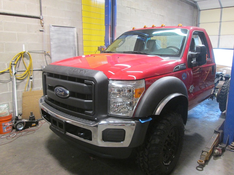

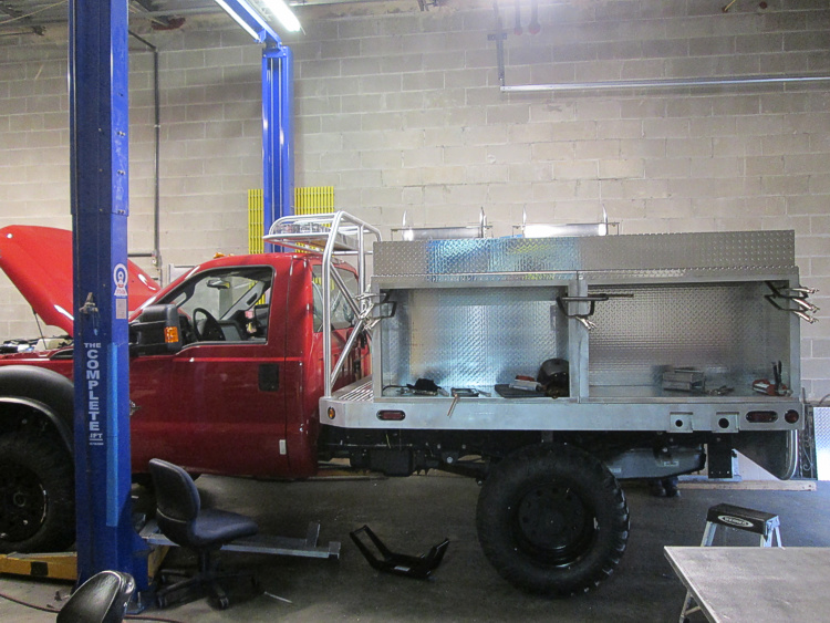

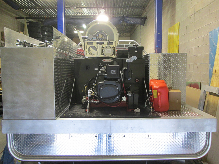

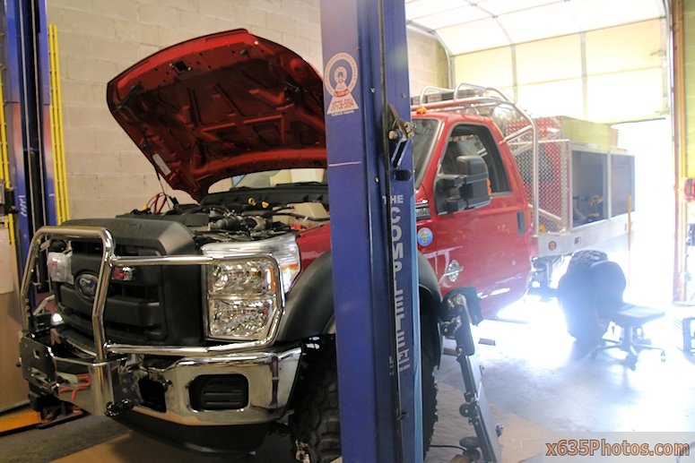

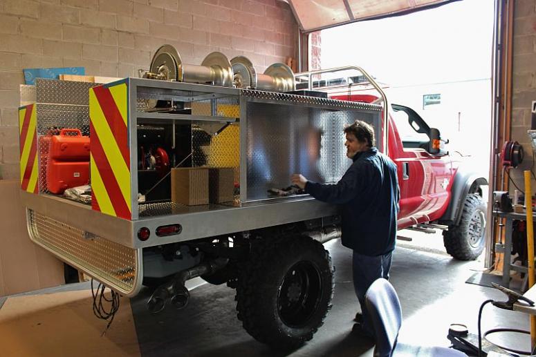

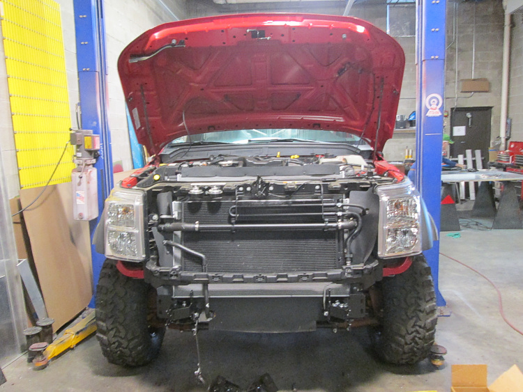

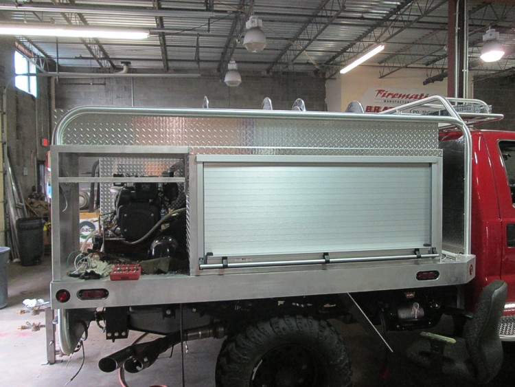

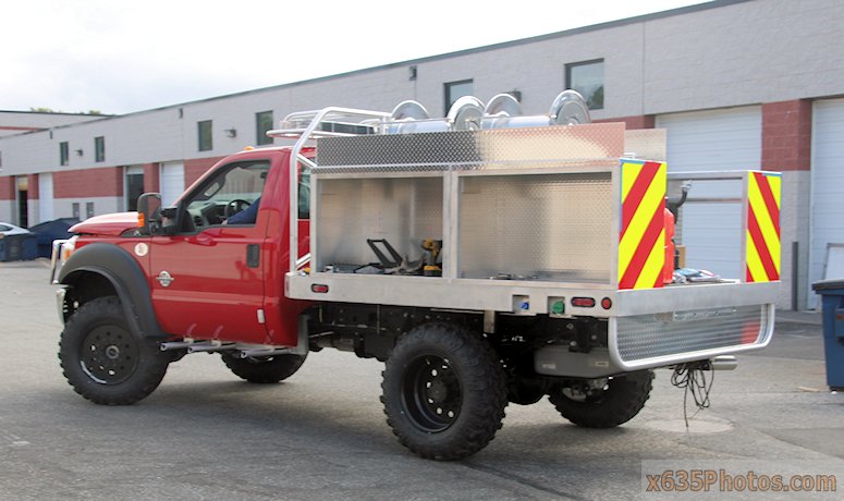

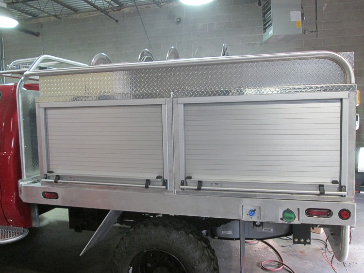

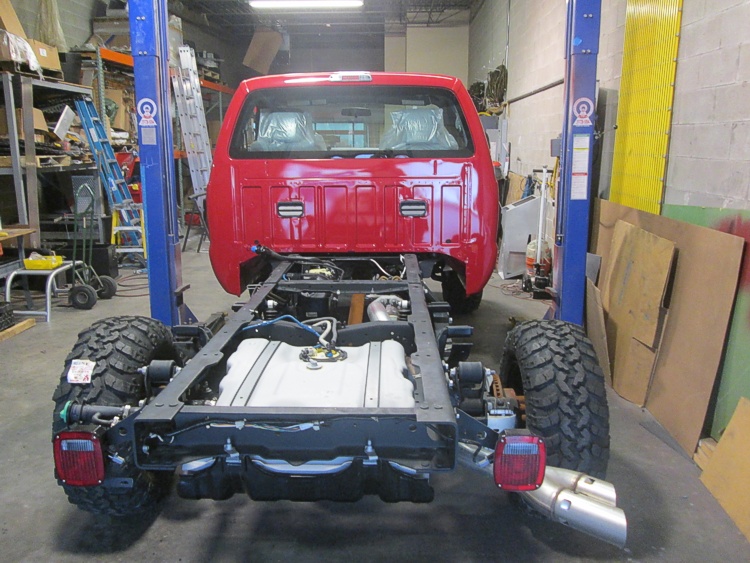

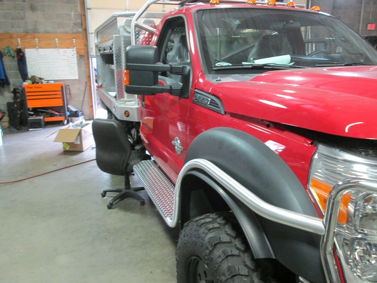

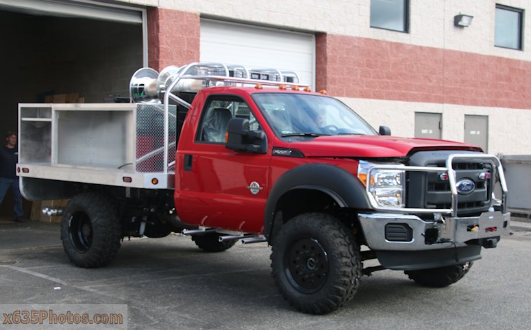

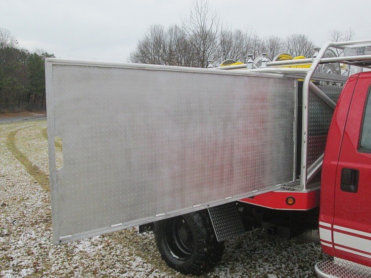

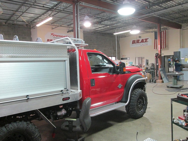

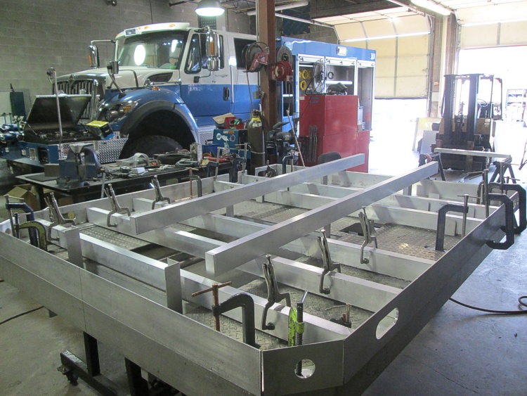

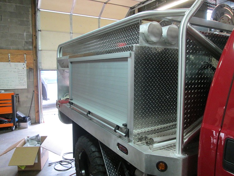

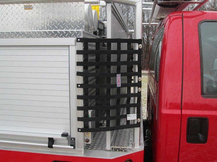

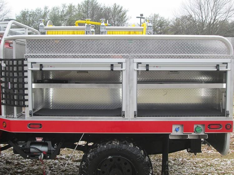

Pawling our neighbors to the South has a B.R.A.T (Brush Rapid Attack Truck) under construction at the Firematic Shop on LI in Shirley N.Y, the same location that built our BRAT as well as are building our Engine. Here are the specifications of their unit.
  • 2013 Ford F550 2 Door Cab 4x4 Chassis with 19,500 lbs. GVW
  • Super Single Aggressive Tread 19.5" Interco Irok Tires
  • Heavy Duty Aluminum Fabricated Flatbed with FEA Tested Roll Bar
  • Pro Poly 250 Gallon Protector Tank
  • CET 19 HP Diesel Pump w/ Remote Cab Start/Stop
  • Scotty Class A Foam Around the Pump Eductor
  • Akron Brass Valves and S/S Manifold
  • 1.5" Rear Direct Discharge
  • Electric Primer
  • Large Deadlay Hose Bed Area
  • Elkhart Sidewinder Remote Control Front Deckgun
  • Two (2) Electric Hannay Reels to Hold 1" Booster on Water Tank
  • Front Warn Trans 4 Mer Grill and Bumper Guard
  • Side Aluminum Pipe Nerf Bars and Side Steps
  • Three (3) Aluminum Diamond Plate Compartments with ROM Roll Up Doors
  • Whelen LED Lighting and Siren
  • Two (2) Receiver Tubes Under Each Side Front Body
. Photos added with permission from David Horton of Firematic, I am traveling to Firematic on Monday and will get some updated shots of the unit, Seth will be going too so I am sure he will be bringing along his camera as well.

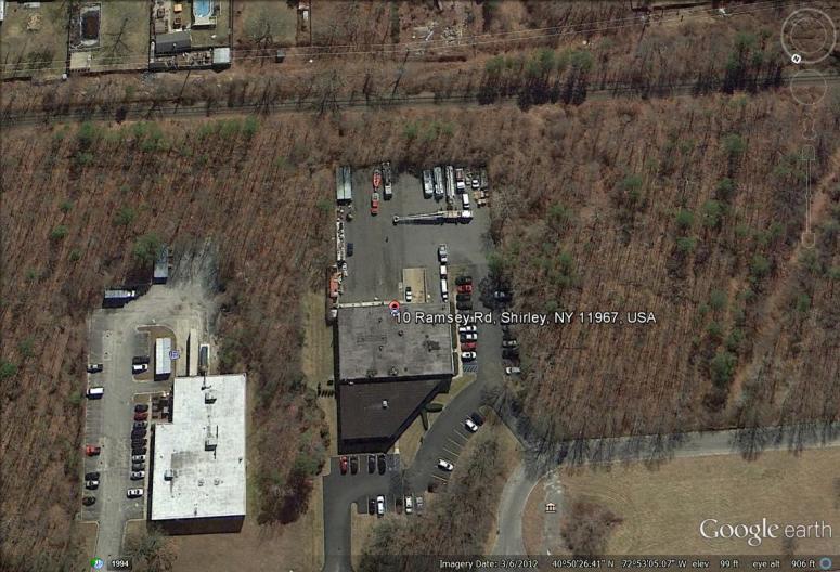

How big is the Firematic facility. The pictures always look like its very cramped for space.
markmets415 likes this
As per google Firematic
Edited by Reliance
That Google image is for Firematic Fire Equipment and their Pierce dealership and service facility.
The Firematic BRAT facility is located a few blocks away in an industrial park.

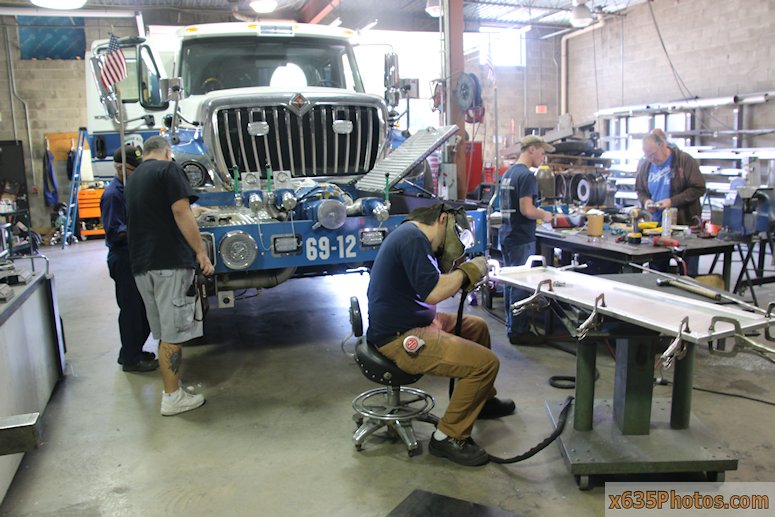

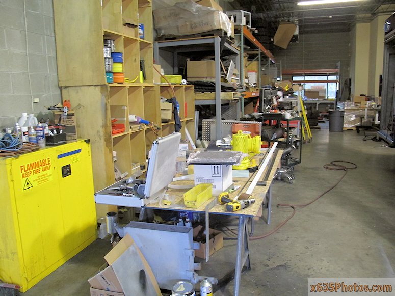

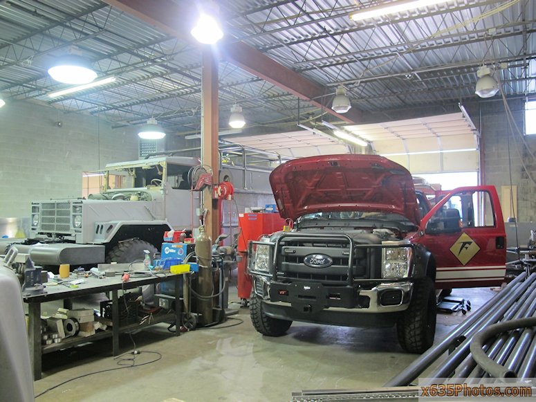

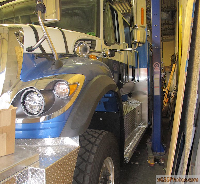

For the amount of work they are doing now, they are definetly outgrowing the space. And they also operate with a very efficient, skilled, dedicated but small team.

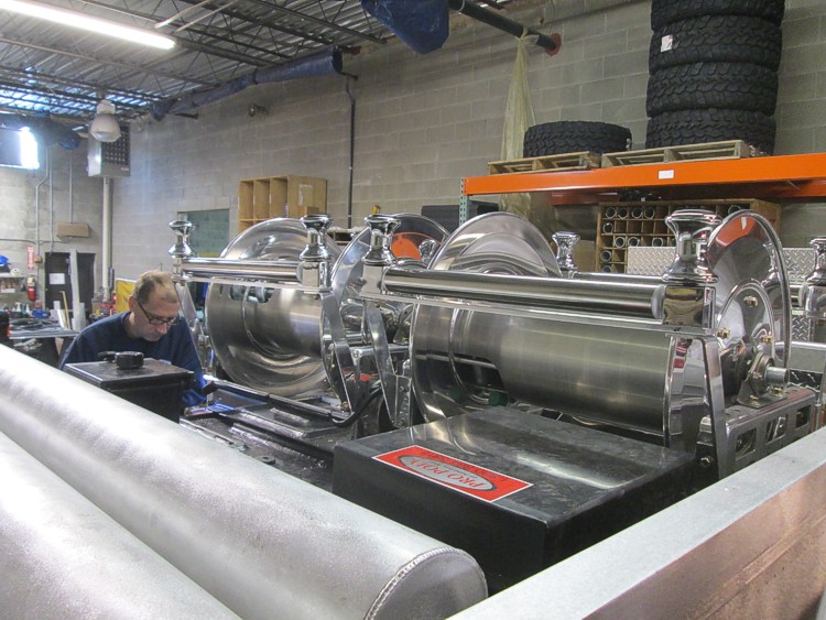

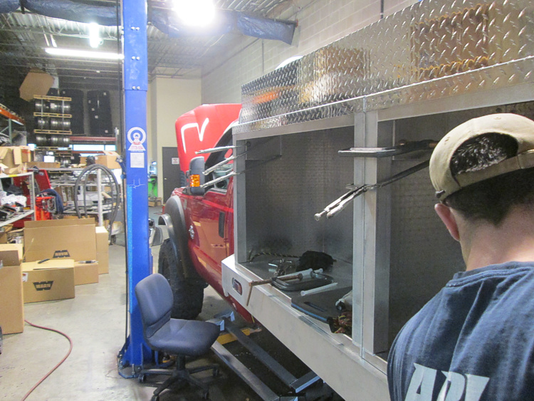

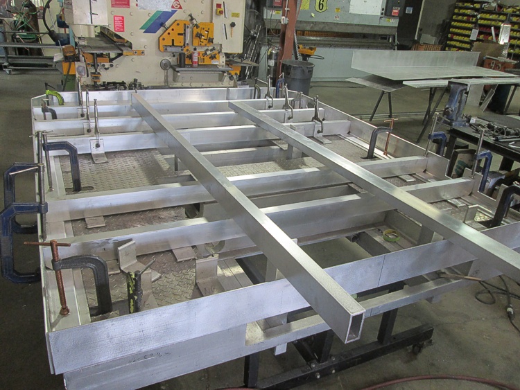

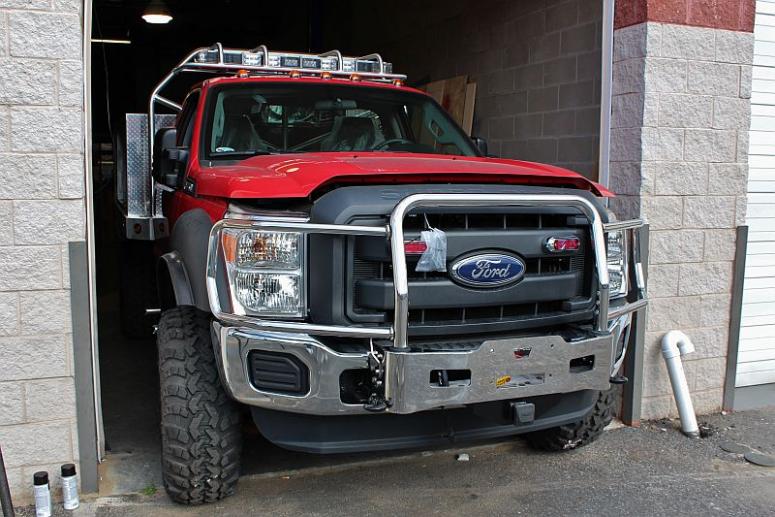

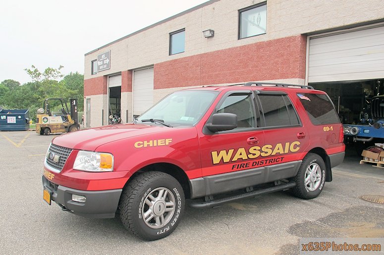

Here's a photo of the front of the place, with Wassaic's not blue like it should be Chief's car. From the car to the corner of the building is theirs.

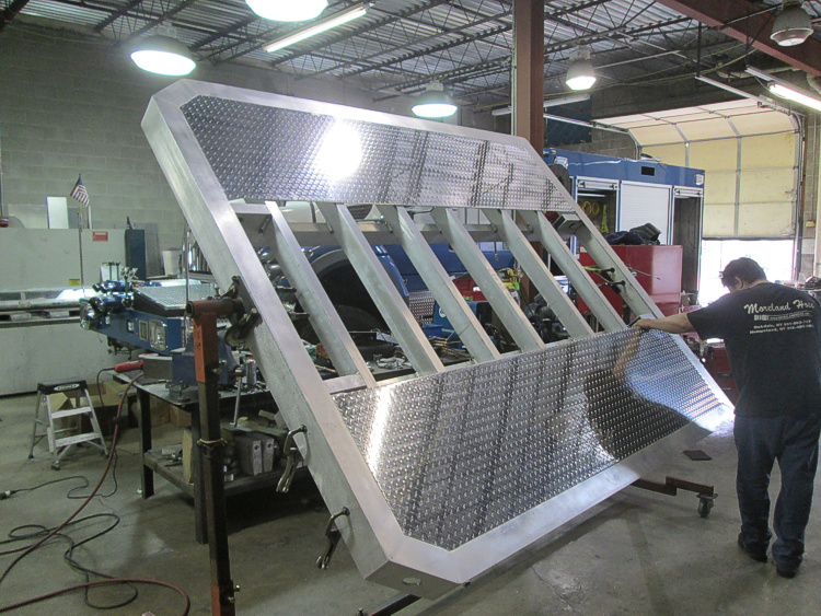

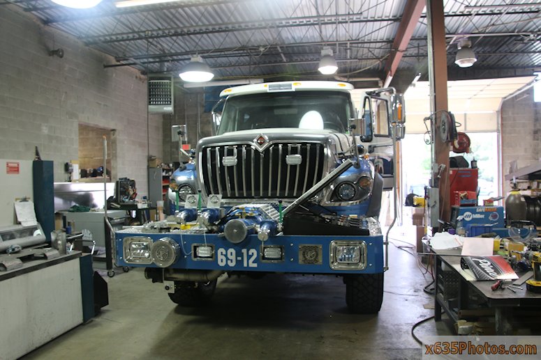

Here's two of the three bays:
Here's another angle:
And another angle:
And the third bay:
And another angle of the third bay:
Yet another angle of the third bay:

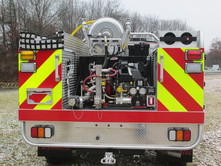

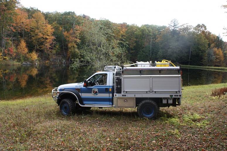

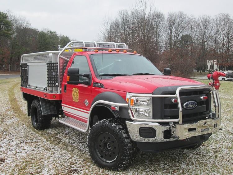

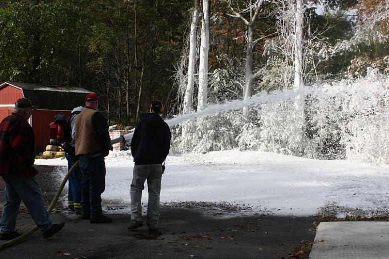

They are attempting to find an alternate site to relocate to for more room as their production #'s are increasing. I can only speak from our experience but our BRAT had far exceeded any expectations that we had for it, it has been called out to several mutual aid departments in NY and neighboring CT, if you haven't seen it here it is.
And me flowing Class A foam using our Port-A-CAFS unit with our BRAT

Pawling's BRAT had been delivered, may it serve the Pawling fire district and it's neighbors well.
