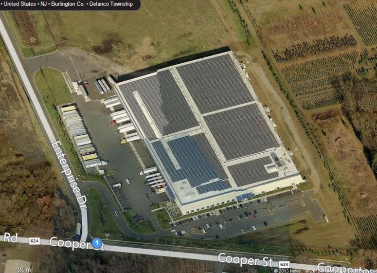

Looking at the roof, they had just a few solar panels
From this picture, It looks like the IC made a good call. One would think that with the almost total obscuration, they would have installed some vents with fusible links for ventilation. But I guess no one ever thinks their place will burn.
