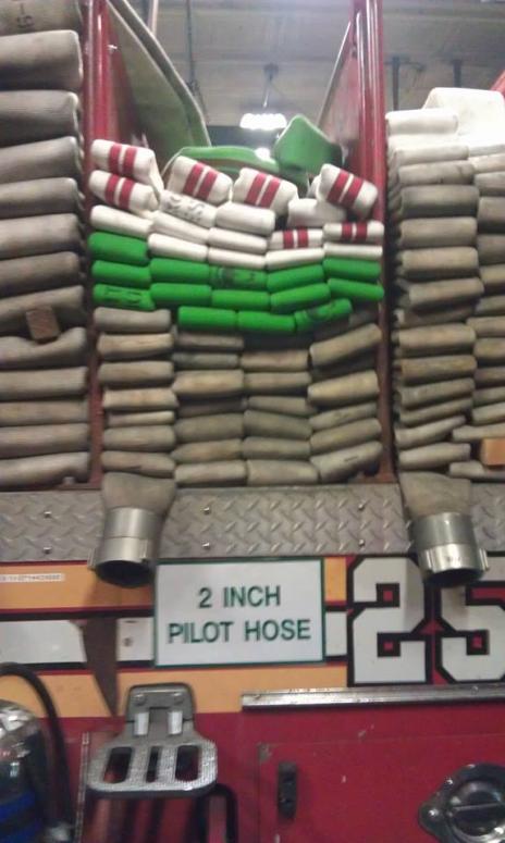

Yes the rumor is true.
FDNY Piloting companies are E62, E75, E255, E275 and E290
Photo Credit: Jerry Fischer

Really? Photo was taken 2 days ago.
The picture was sent to you two days ago. It was ordered removed July 30th. Not one single positive thing to say about it. Heavier and much harder to maneuver.
That photo was taken about a week before he posted it, He said it in the comments.
As of now the use of 2" in hose bed is on hold, some issues developed with hose during stretching, when i get more specifics will post, if you look at picture the lead length was green then 5 lengths of white and then 4 more green, reason being FDNY uses 6 lengths of 1 3/4 followed by 2 1/2 so in order not confuse members when estimating hose stretches they put the 1 and 5 to show 6 lengths off and when you get to 2 1/2 you have 10 total out. Many stretches in tenement areas require more than 10 lengths to reach fire.
The 2" hose is still being used off standpipes as the lead length this has not changed.
