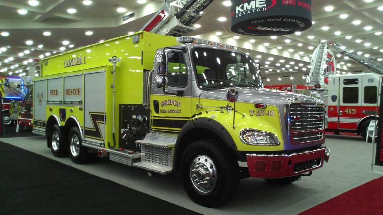

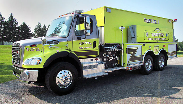

suffernH&Lbuff
(Delivered) Esopus Fire District
25 posts in this topic
County: Ulster
City/Town/Municipality/Dept: Esopus Fire District
Unit designation/identifier: Tanker 27-11
Chassis & Body (or Aerial) Manufacturer and model: Freightliner MS 112 with 2 Door Cab KME
Pump size, tank size (water/foam), aerial type & length: Hale DSD-125, 12500 GPM Single Stage Pump
Intakes: Driver Side: 6" & 2 1/2" : Officer Side: 6" & 2 1/2"
Discharges: Driver Side: (1) 2 1/2", Officer Side: (1) 3" & (1) 2 1/2" Rear: (1) 2 1/2" OS Sleeved, Other (2) 1 3/4" Crosslays
Side Mount Pump Panel
3000 Gallon Poly Tank
(3) Newton Dump
(1) 2 1/2" and (1) 4" At Rear
Estimated delivery date: Finished,Displayed at Baltimore Fire Show 2013
Status:
Notes: PHOTO BY KME
Edited by suffernH&Lbuff
County: Ulster
