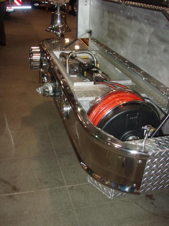

Can't remember where this one is from, but it is a 2007 Spartan/Crimson that was shown at the 2007 New England Chief's show. The bumper hydraulically tilts for easier access.

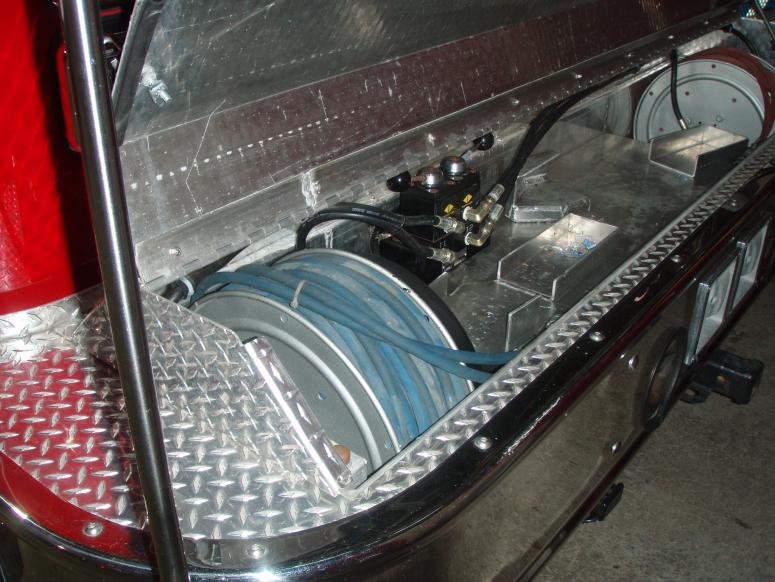

Mohegan FD Engine 258 (2001 KME) has a preconnected Hurst combo tool and preconnected electric cord reel with battery/electric combo Dewalt sawz all plus mounted halligan on the front bumper. Mohegan FD Engine 252 (2010 KME) has a preconnected Hurst cutter and a preconnected Hurst combi tool mounted on the front bumper

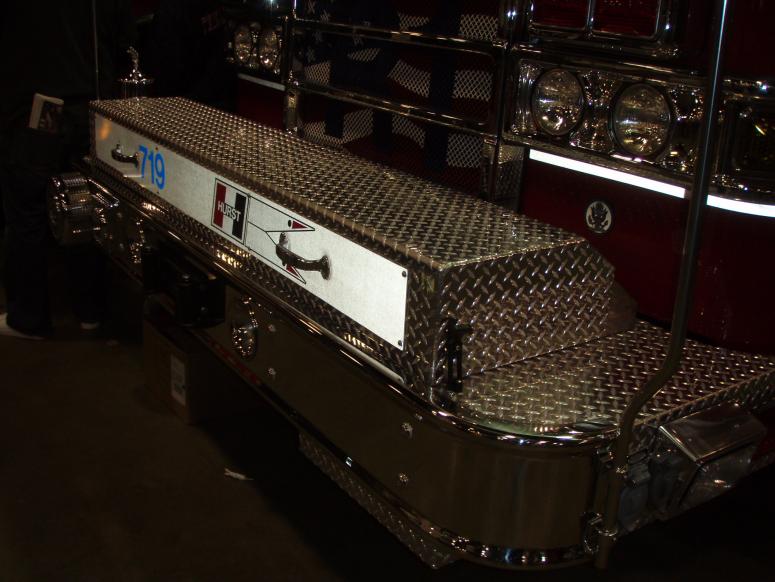

Have a question and maybe someone could provide some insight. While I can see the clear advantage in a front mounted, pre-connected Hurst tool set aren't they susceptible to road dirt and salt especially in the Northern East? Does this type of road grime hinder their smooth operation as opposed to being placed in a side roll up door compartment and possibly a "pass thru" compartment with access to the pre-connected tools from both sides of the rig on a pull out tray? Love the idea of the front mount especially with the hydro-tilt but just a concern that hit me in looking at the rig pictured.
All the ones I have seen are covered with a "diamond plate cover" well sealed against the elements. But it is a good point. That tilt bumper rig looks impressive, but is a bit much for my needs. Im thinking a cutter and a spreaders both preconnected to reels and 100 feet of 1.75 hose with nozzle. 100 feet or so of electric cord on a reel would be cool and nice to have, but not a need. The need is the 2 tools and 100 feet of line.
As noted it's the "Battenburg Beast" from Hubbardston, MA. IIRC the tilt option was thrown in as a "show special" by Crimson and not specced by the FD.
And rumor has it that because of the tilt it was out of service more than in.
Tough to justify an additional $30,000 for that feature.
All the ones I have seen are covered with a "diamond plate cover" well sealed against the elements. But it is a good point. Im thinking a cutter and a spreaders both preconnected to reels and 100 feet of 1.75 hose with nozzle. 100 feet or so of electric cord on a reel would be cool and nice to have, but not a need. The need is the 2 tools and 100 feet of line.
They are sealed underneath (which is where most of the grime is coming from and with a good cover they stay clean. In fact there is less road spray there than in the side compartments.

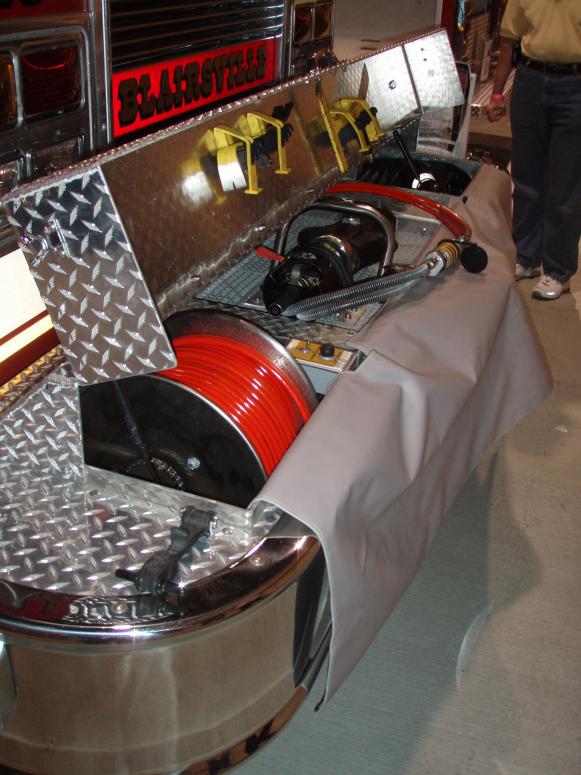

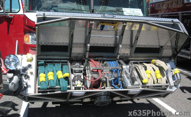

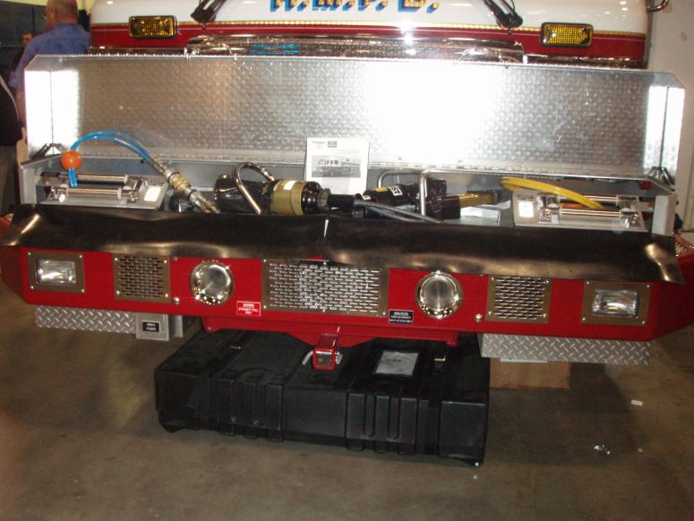

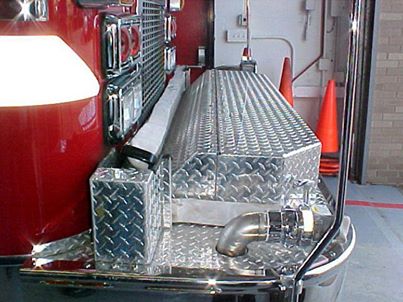

A few others:
I have seen a few that got 2 reels and 100' trashline, but most do not have the space.

Cairo,NY's Rescue has a foam system hose and Holmatro tools in it

On our Marion Heavy Rescue, we have 2 100' reels for our Amkus tools. We keep a Combi-Tool pre-connected. There is also a 300' electric reel with a pre-connected sawzall. We have a rear roll up in which we keep our gas unit, heavy duty spreaders, cutters, and rams. The setup works well. http://www.marionbody.com/products/finals/combo/CopakeCombo2010/index.html

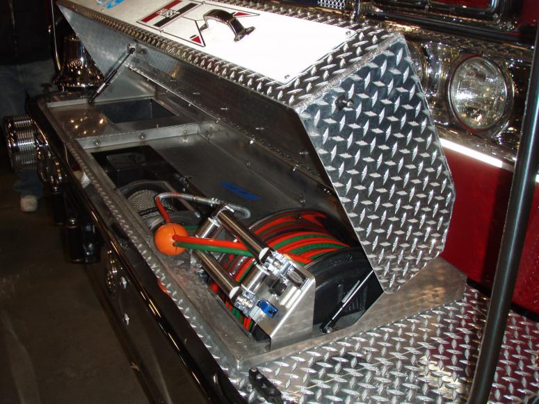

Like this? :P

Yes, exactly like that, Bnechis!
