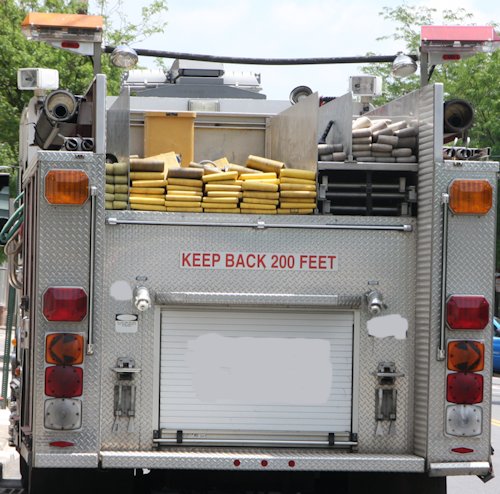

So, I've been driving through some fire districts over the past few months, and I've been noticed 1/2 to 1/4 filled LDH hose beds.
Some of these departments have areas where they need to relay pump, especially up hills, and others have had water issues and have potential water issues. So why skimp on hose? Great hydrant system? What about in a disaster or water distribution problems? Incident on a major highway? One apparatus can't be expected to carry all the LDH for logistical reasons.
Other then "that's too much to pack and test", why not fill a bed with LDH? I was thinking weight issues, since some of the departments have floor problems, but still. I was in a volunteer department that carried a lot of LDH, but we had areas of our district and mutual aid districts where it was absolutely needed despite hydrants. Heck, departments used to special call us for it. It was a great insurance policy.
Maybe I'm just out of the modern loop, and there really isn't a need for LDH in an urban hydranted district.
Here's an example. (Blurred to protect department's identity). I'm not trying to pick on anyone, but just curious, and need to use a visual example:

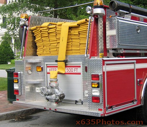

We used to carry 1000' on our engines: until the day we had a fire 1200' from the hydrant. Now we carry 1400'.

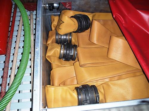

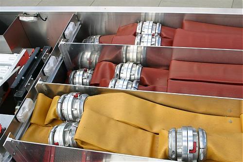

Sure, though we may have been behind and this might be obvious to some. We lay the LDH from the rear of the bed to a point 18-24" short of the head of the bed, laying one layer the width of the bed then starting back with the second and subsequent layers. The space left open at the head of the bed is used for couplings, anytime you have a coupling you move it to that open space and short lay or create a fold to ensure the coupling doesn't have to flip, they always pull straight out. then continue the lay as normal, but always placing the couplings up front. This removes any coupling "bumps" in the lay and typically ends up with a neater lay that takes up less space. This was a real help to us as our engines all have hard deck hose bed covers and the last few lengths often were tight to the cover if couplings ended up close to each other mid-bed. I'll look for pictures that we have that show this lay.
Thanks Antique
We used that method from 1988 till just a few years ago. With our new extra low (but short) hose bed we went back to a standard flat load and found it was better as we didnt want to give up the front of the bed for just couplings.

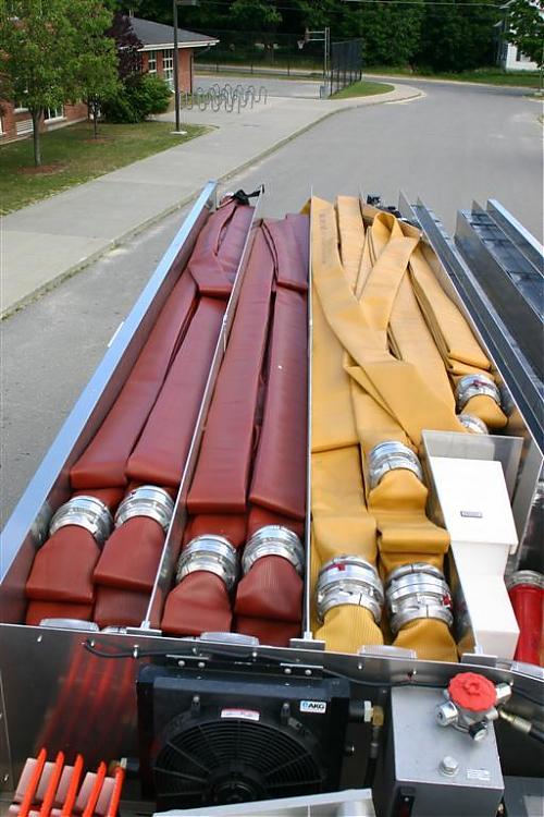

Here's a couple of pics from other apparatus that we'd taken the idea from. I will note that we use the method as it looks but with the exception that we do not lay hose over the couplings. They show a manner that you can load when the bed is not too deep but use the same concept by placing the first tier of couplings at the head of the bed, then another tier in the low spot just back from them. Another thing this does for the load is keep couplings from having to pass each other in the bed, which can be problematic if the load is tight side to side.
