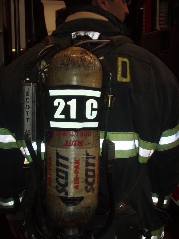

We also added Position/Radio ID tags on our SCBA. This has been useful on the fireground in see who is who. post-4072-0-68642000-1370189869.jpg
