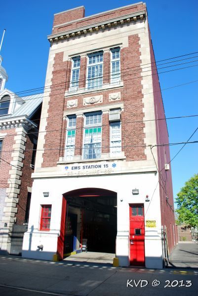

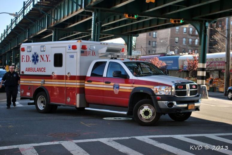

Back in 2011/2012 there was a lot of speculation on the web about the new ambulance FDNY EMS was in the process of buying. It was a Dodge/Wheeled Coach with a 4 door cab. I recall reading somewhere that FDNY was going to purchase up to 285 of them. I know they started to take delivery, and then it seemed like they stopped. Was there some type of problems with them, or was the design found to be deficient in some area. I have only seen a few on the street of NY. Here is a photo I got of one today at EMS Station 15, just a few blocks from the 5 Alarm fire on White Plains Road in the Bronx.
EMS Station 15, ex quarters of Engine 63

They are everywhere, with most stations having at least a few. Yes, they are not as dominant as the F-450's, but they are around. I have heard issues with the air-suspension not re-inflating, and other minor issues.
Being able to recline is the best part about those Dodges. And as was mentioned there are plenty of them around, and I did hear that there were more on the way, but that was a casual comment in a conversation so that isn't confirmed. My unit is a Dodge and it has around 15k miles on it and has already had its engine replaced, I'm not sure whether that is a common thing or just some issue with that particular truck. Air ride is hit or miss, its supposed to deflate when both back doors are open and with the engine on, but around 30% of the time nothing happens, even after repeatedly opening and shutting the doors. Not a huge issue but a little consistency would be nice. Driving around is a little different with the extra length but the width is the same on the f350 models. The engine is quiet and really smooth which is nice when you are sitting 89. There are definitely mixed feelings about the Dodges, but personally I like them.

I think the reason they didn't keep getting more of these is Dodge discontinued the chassis that they had been using. In the meantime they've been coming up with a new spec for this.
My unit was one of the first to get 1 of the Dodges. It was amazing to have when sitting 89 (especially because I worked midnights on a slow ALS unit) however they were not as great to drive compared to the Fords. The Fords are much more responsive, however the Dodges actually have a better turning radius.
