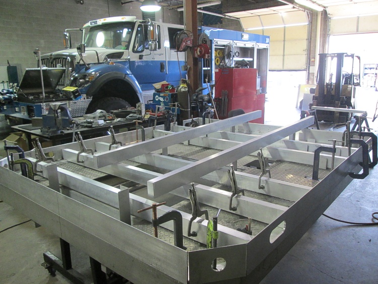

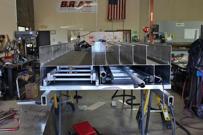

Here is a shot of Pawling's flat bed body under construction for their BRAT with our engine in the back ground

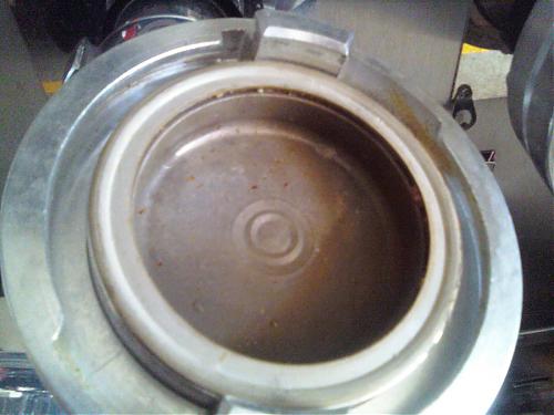

Admittedly I don't know a ton about drafting but I didn't know you could get a good draft with storz connections.
markmets415 likes this
You can, but only if you have the correct gasgets. Standard ones will not cut it.
Storz works well and other depts prefer to use cam locks, as threaded hose requires more time and manpower to set up
markmets415 and Danger like this
Thanks Captain, I was just going say you have to ensure that there are drafting gaskets which is a raised gasket instead of the flat ones in the items that are going to be used

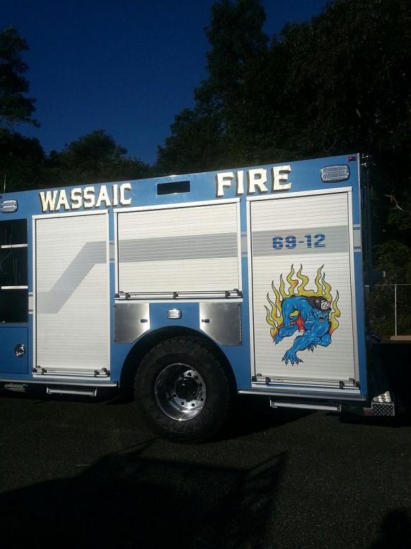

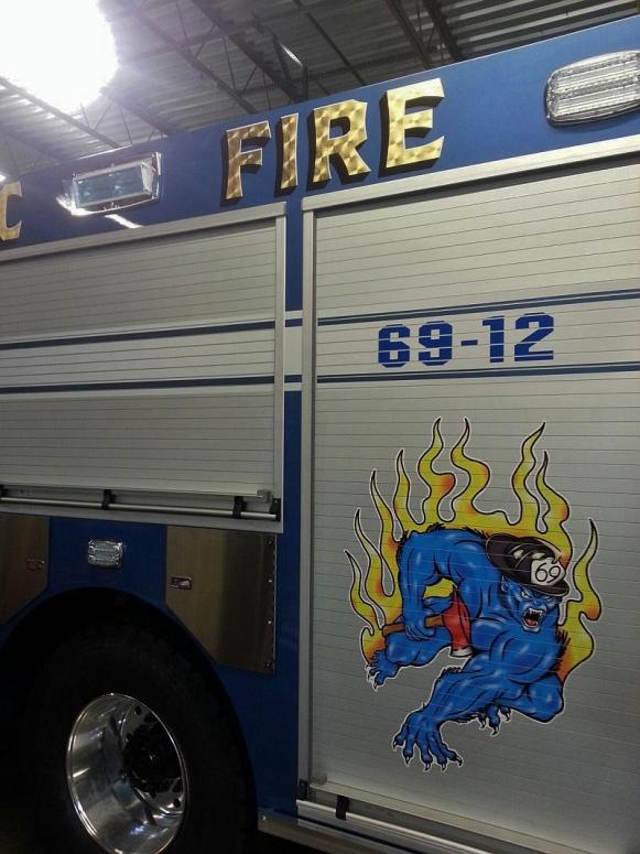

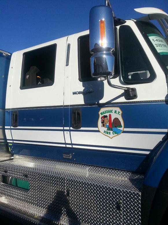

A few teaser graphic shots sent from the shop this morning, the side stripe on the roll up doors will also have a 1" blue stripe applied to follow the pattern off the cab and painted areas of the body
Front door and striping

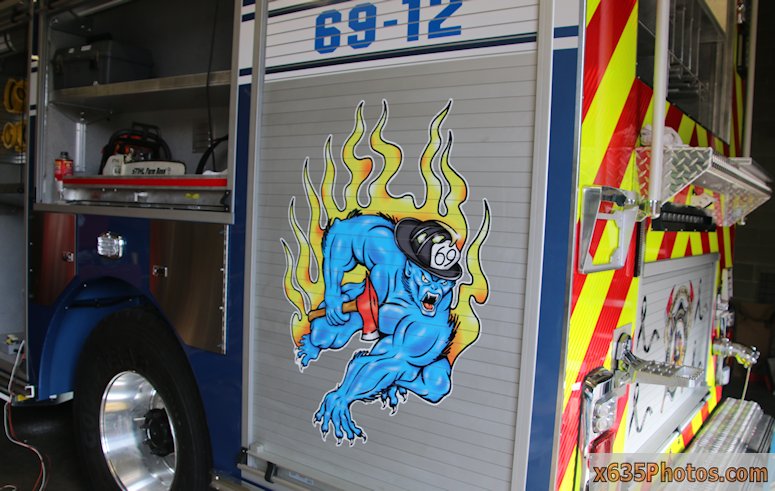

Driver side with the Blue Beast on the rear door

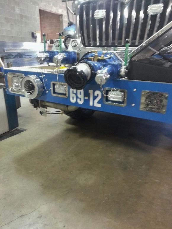

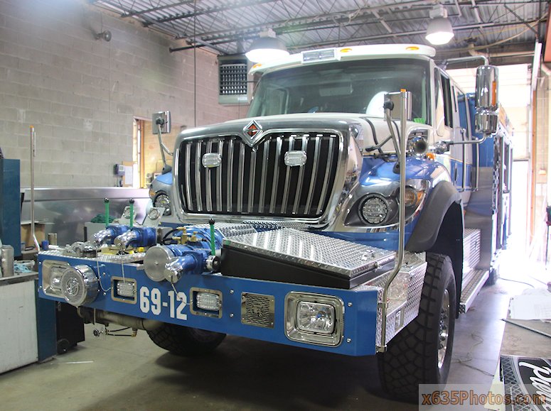

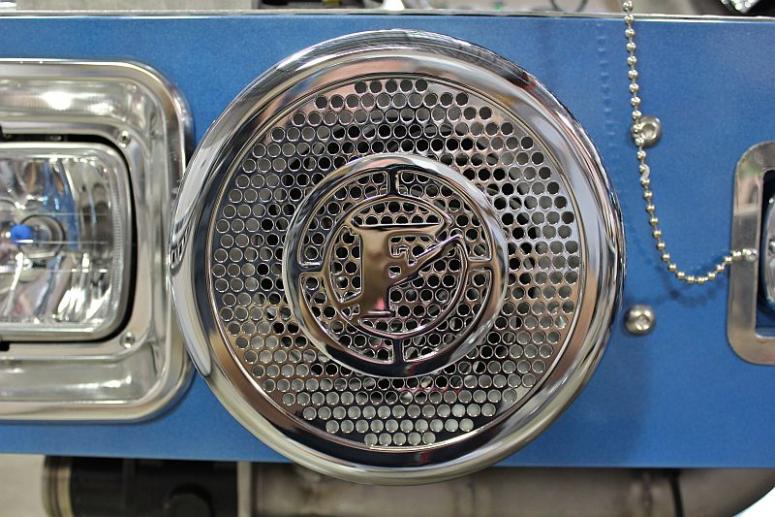

Another one sent from the shop, on the visit I made to the shop Saturday I expressed that I thought the recessed grill lights needed some "dressing up" to match the chrome trim on everything else on the face of the bumper and I also was concerned regarding the discharge and small inlet caps when removed that they would swing downward or be dropped and thus striking the lights, even though they are recessed into the bumper, Tom (who is one talented fabricator and welder and has made most if not all the custom areas and brackets) at the shop looked it over and said he would have a solution to avoid that from happening, so they just sent me a quick photo of his solution, he made stainless steel trim pieces for the lights and attached the chains for the caps to the screws holding these trim pieces on thus allowing the caps if dropped to fall below the bumper, nice job I must say. I will have them move the chains to the sides on the visit Monday so they don't hang down in front of the lights but non the less a nice solution that looks even better.
An earlier picture of the front bumper from last week
From today

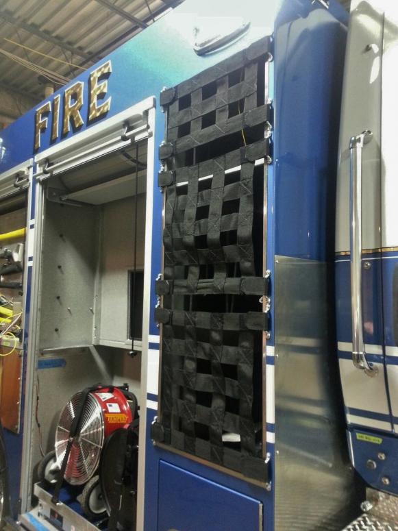

A few more teaser shots sent from the shop this afternoon
The 1" blue stripes have been installed on the rear body and a better look at the upper gold leaf lettering
Netting installed for the speed lays, each of the three areas were done individually at our request.

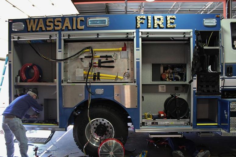

Tom installing the bottom mount for the cutter/spreader, you can see the wiring harness for the passenger side of the truck that has to be run to each light, this is the main reason for the extra two days until delivery

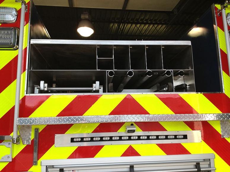

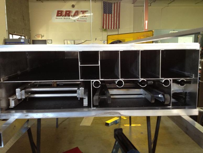

The custom area designed to hold the ladders, small suction, 6 hooks and now one open area to be able to place long tools in, which is the upper right area.

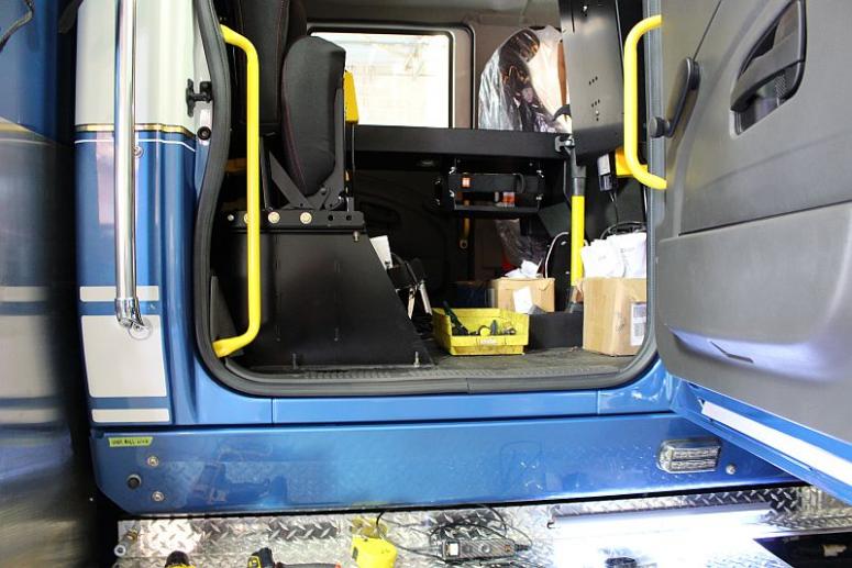

One additional item that we did was to have Firematic send out the grab handles into the cab located at each door (inside) to be powder coated yellow for just that extra visibility in entering and exiting the cab in the dark.

The custom ladder, small suction and hook area is now completed, by opening up the little giant ladder and lying it flat fully open we were able to mount four hooks above it, thus freeing up an open space for some long tools (upper right boxed area). The custom box was mounted on the Engine this afternoon, thanks to x129k for the input on the hooks, as you can see there are now six hooks, with different sizes and types, much appreciated Dan!!!!

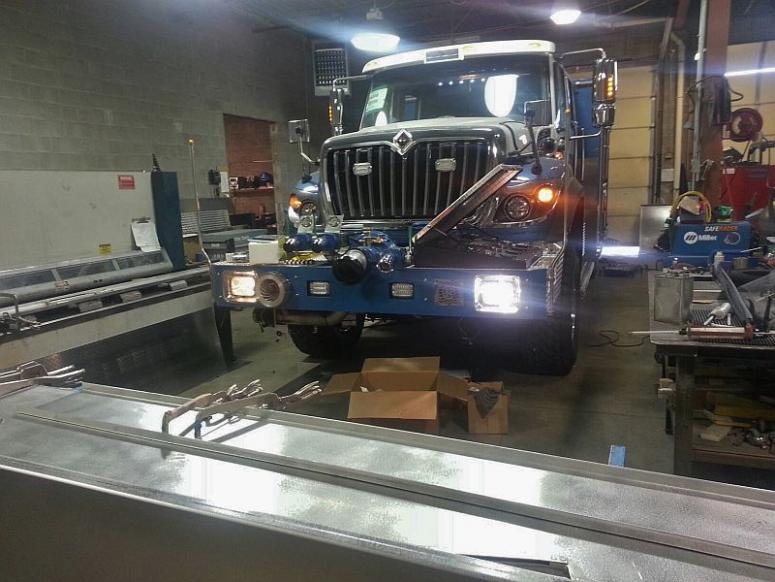

And just sent from the shop the box is now mounted and for 4093x, we decided to not add those lights to the ends of the arrow stick and here you can see the new stainless trim piece placed around the light!

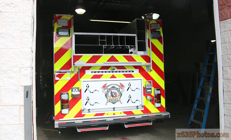

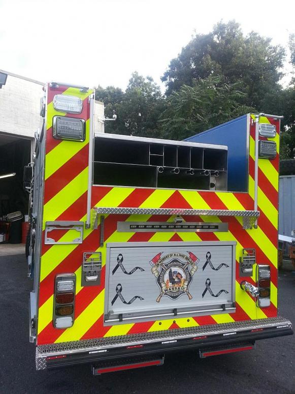

Engine is at the International dealer to get the governor programmed to communicate with the CAFS compressor and they sent me a shot, finally get to see most of the rear of the unit, the suction area was removed yesterday to place the ladder box in and will be placed back in when the rig returns this afternoon to the Firematic shop.

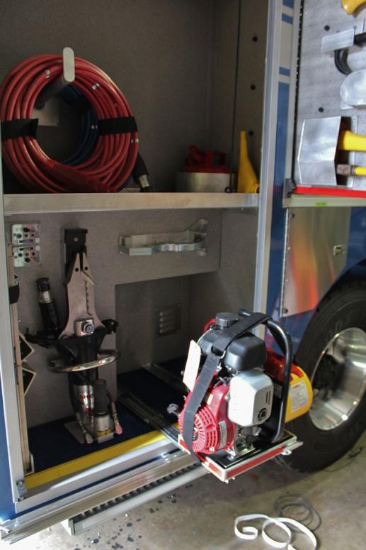

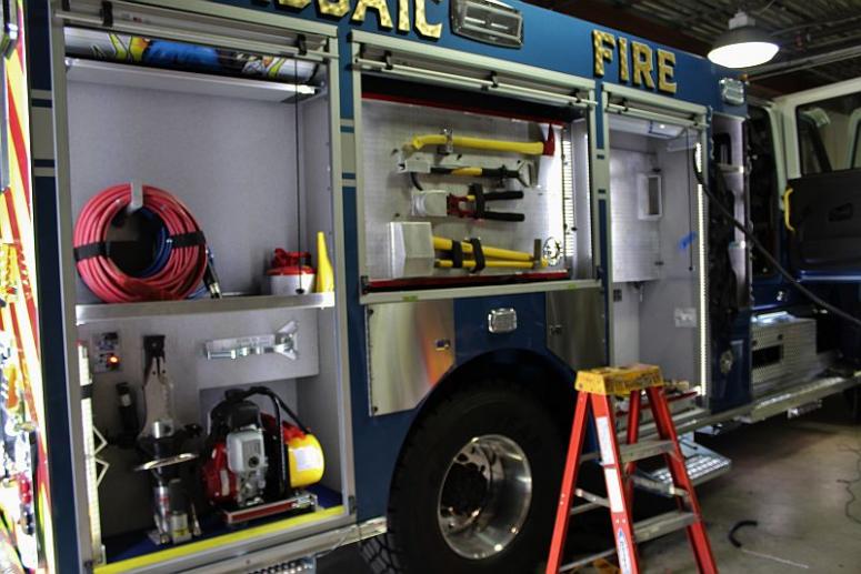

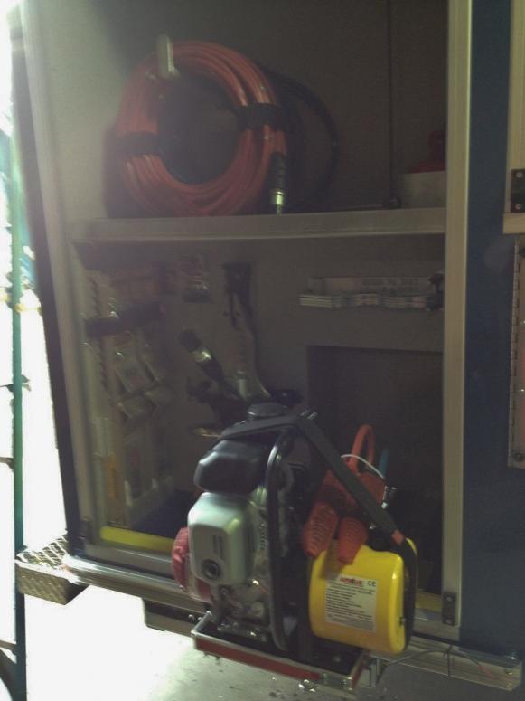

Sent from the shop today, although not the clearest pic (cell phone) you can see the components mounted in the passenger side rear compartment, they finished the compartment up by placing the hydraulic pump on a small slide out tray for ease of getting the unit out of the compartment. There are a set of auto cribs mounted on the left wall, the combo cutter/spreader on the rear face, the slide out pump and on the rear wall right side is a set of combo spanners 2 1/2" to 5". Also the auto fill over ride and manual controls are on the rear face of the compartment as previously shown. The upper shelf has the hydraulic lines and gas can mount. I will get better shots on Monday of all completed compartments which hopefully should be all of them.

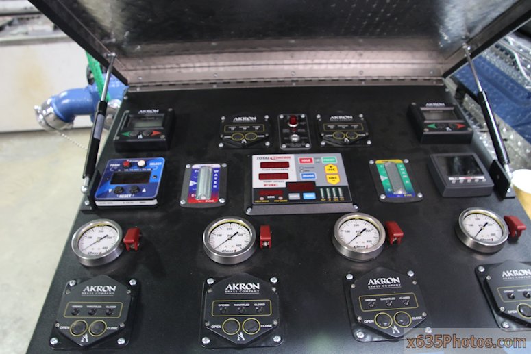

The pump brains

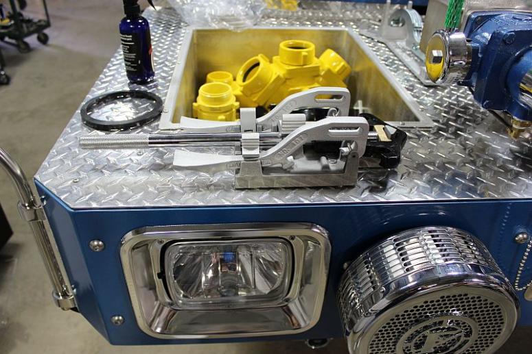

The hydrant wrench and spanners and the LDH spanners (upper right) mounted to the extended front bumper area

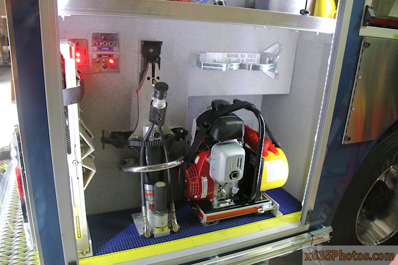

The mini slide out custom tray made to fit the hydraulic pump

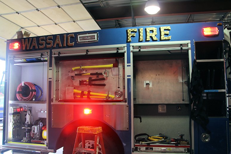

A side shot of the LED compartment lighting on

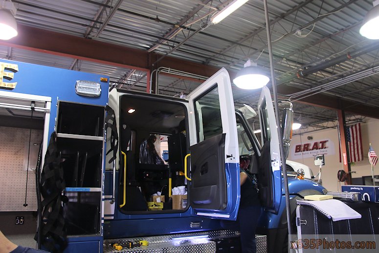

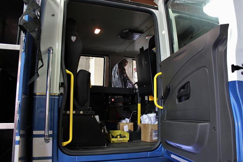

Open cab door shot showing the yellow powder coated grab handles at the entrance to the cab that we asked for at last weeks visit, in the background you can see under the console an open boxed area, this is for the AED and you can also make out the TNT tool mounted vertical to the right of the AED box. You can also see the water can which is mounted under the rear seat, you can see the handle, yes the rear seat bottom always fold up when not being sat in, this allows more access into the rear of the cab to get any of the items there or on the rear part of the console.

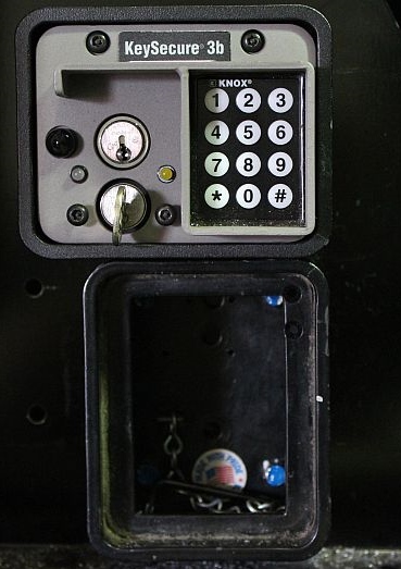

The knox boxes installed on the passenger side front officer's seat riser

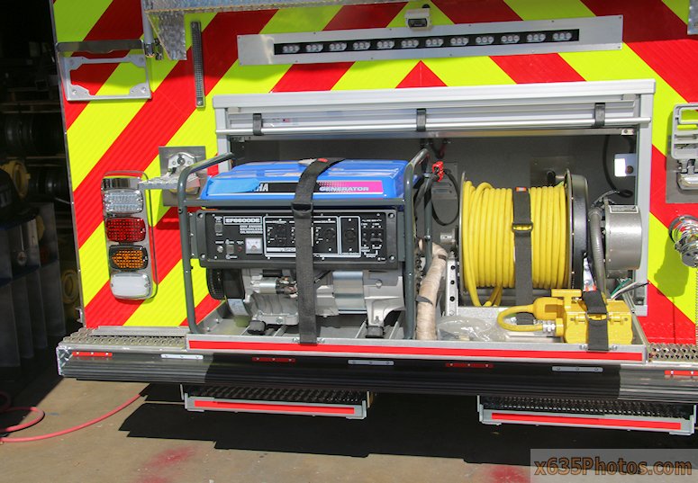

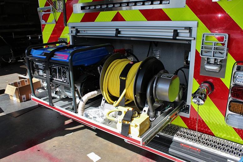

The 6600 watt generator and reel tray pullout

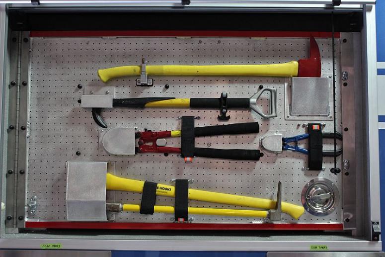

The completed front of the tool board with the red reflective tape and the mini bolt cutters added today and custom mounted, also you can see on the right side of the tool board mini Amber LED flashers, they were added to the front and rear of the tool board and will flash when the board is unlocked from the D handle

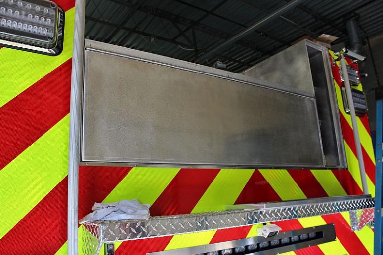

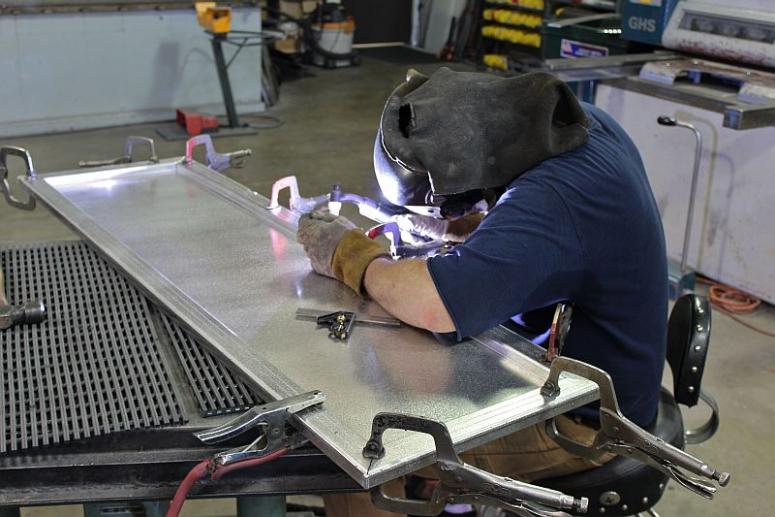

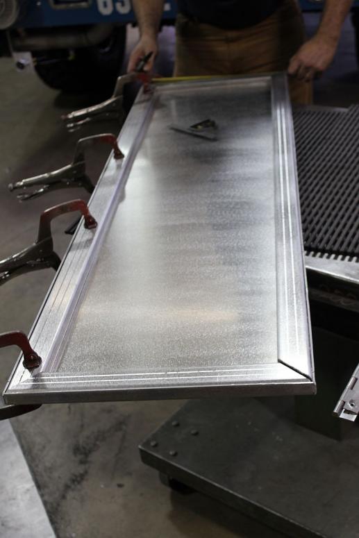

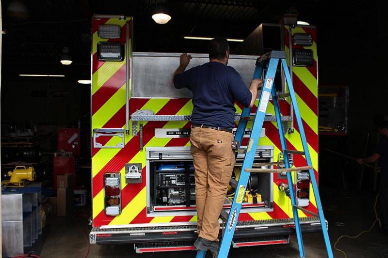

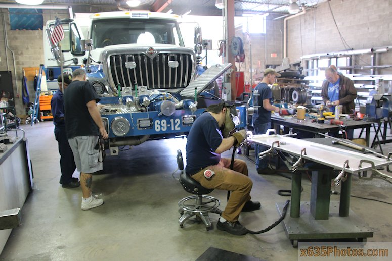

Watching Dan make the rear doors today for the ladder and suction areas was pretty cool and a few of Seth's I added to caption them.
Door being constructed
Dan welding the pieces together
Dan testing for fit
Ladder door installed, chevrons to be added and Dan was off to finish the suction door

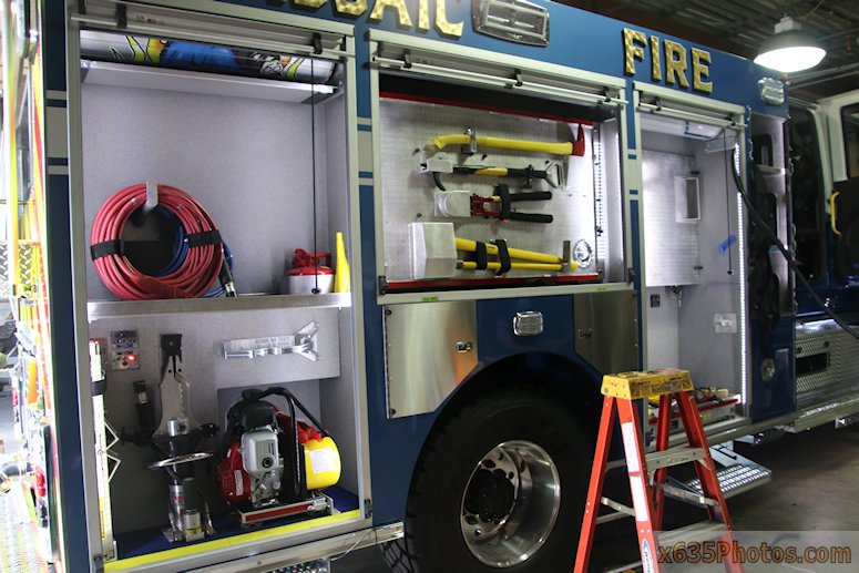

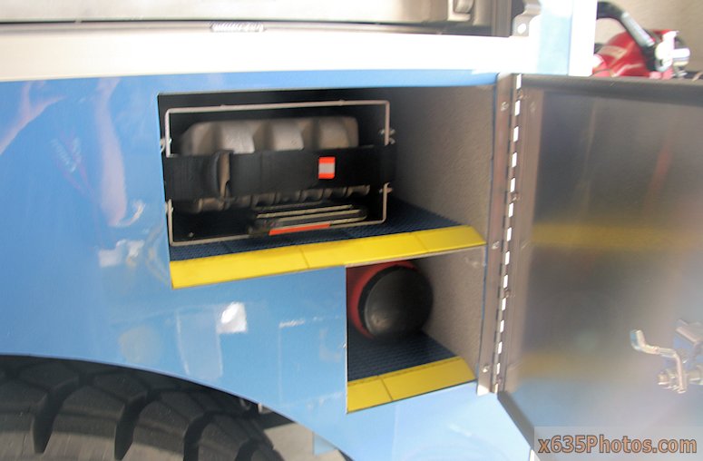

Seth's photo, this is the driver side rear wheel well compartment which houses one folding wheel chock and the flare container, the front one houses the other chock and a 20# fire extinguisher.

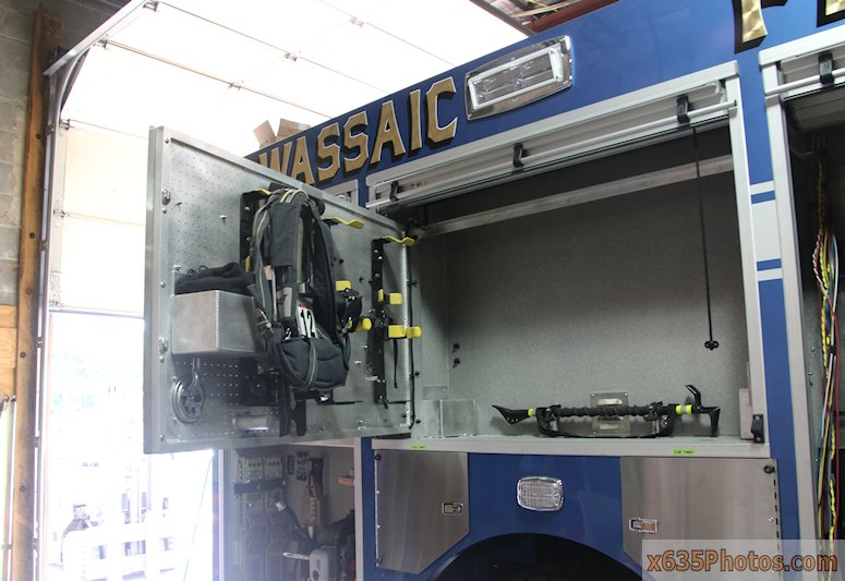

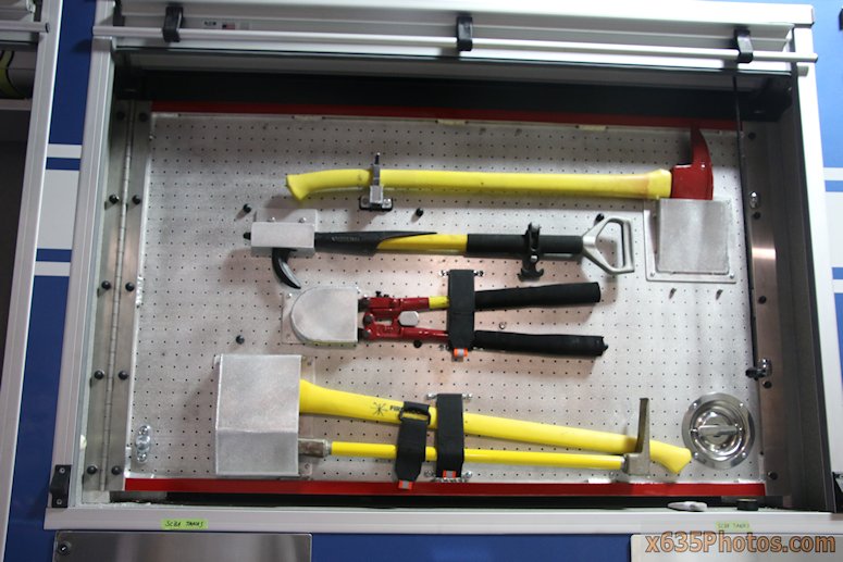

Seth's photo showing the rear of the tool board, they added three aluminum boxes, one on the board and the other two in the side corners to house the SCBA masks, also this one is for x129K so you can see the 36" Griff hook mounted.

I have always liked those swing out walls(last picture to make it simple) seems like a great idea.
