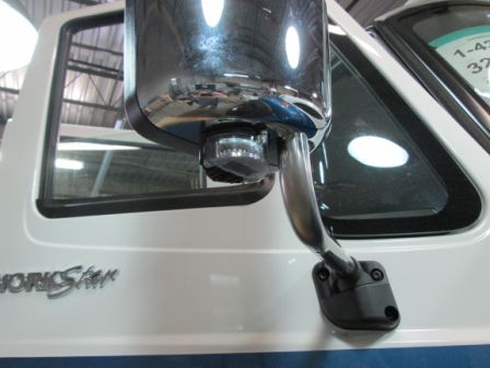

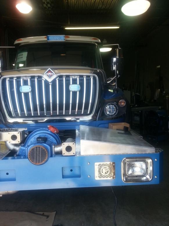

Here is the soundoff signal intersection light designed to be mirror mounted.

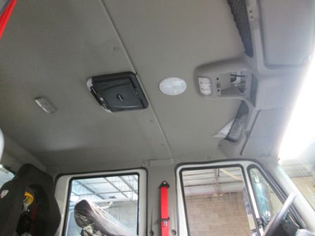

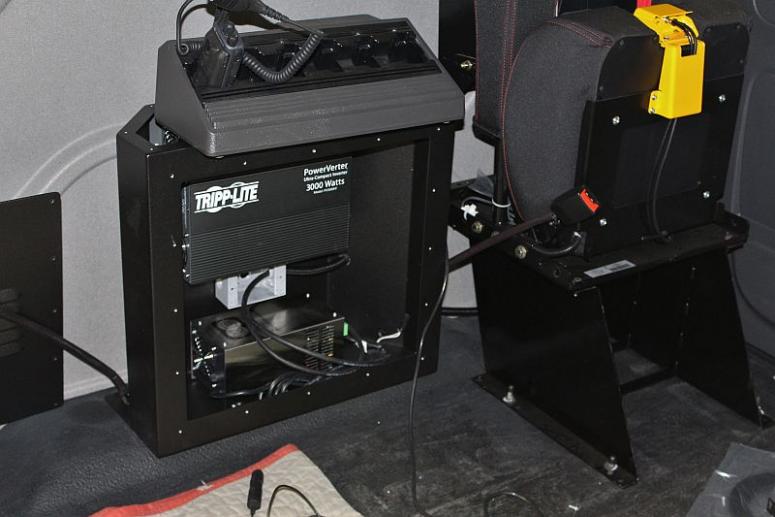

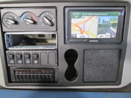

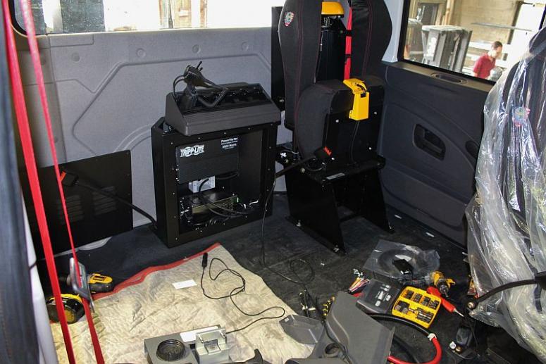

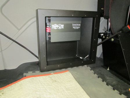

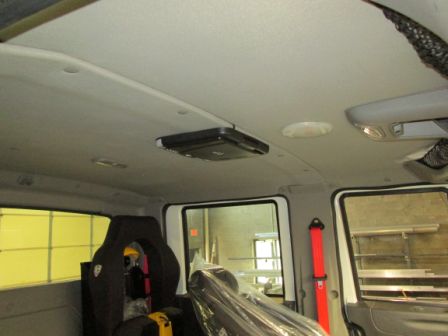

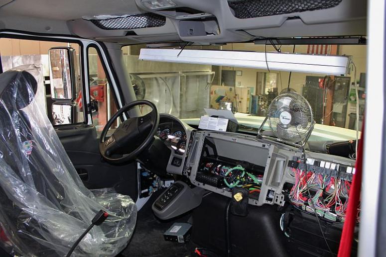

Shared from the shop today, a personal visit will take place next week. GPS and backup camera monitor installed on the dash, the intersection lights mounted under the mirrors, the 3000 watt inverter which has 4 GFCI outlets which will also have an external duplex receptacle and will also power the on board refrigerator and the 12" flip down monitor that swivels 360 degrees and will be used to monitor the TIC.

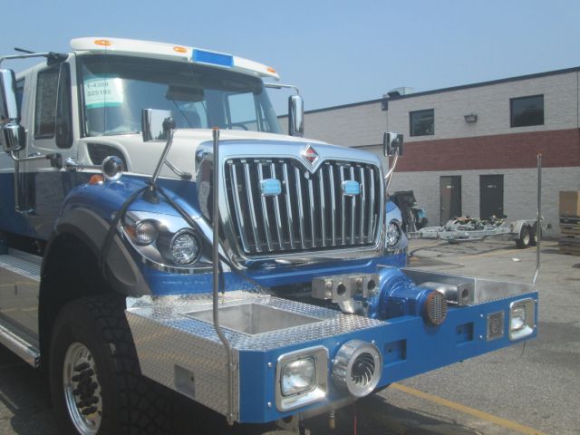

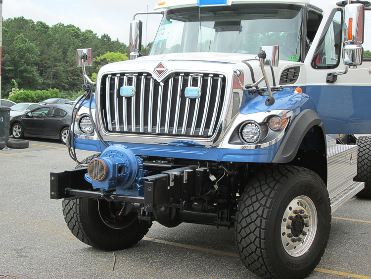

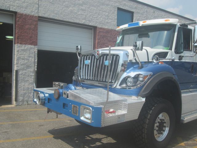

I am an EMT not a fireman, but it would seem that the 5" inlet/discharge under the extended front bumper would get damaged easily. Was there no option for placing it in the bumper itself? Just curious..
Measured today, from the ground to the cap of the 5" discharge is 23" and to the valve 24".
Taken on Wednesday at the shop

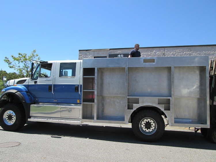

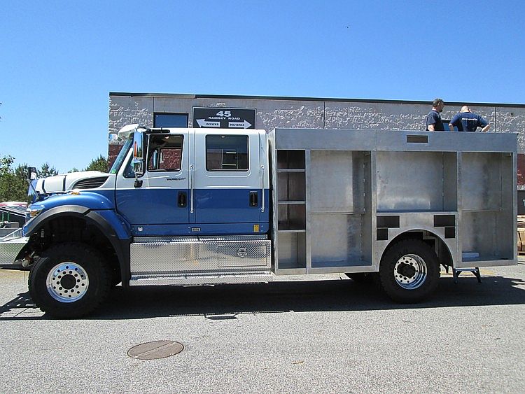

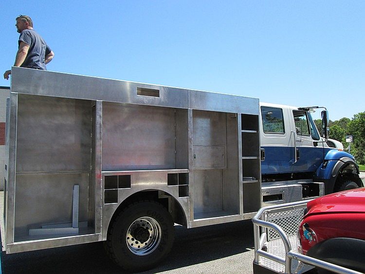

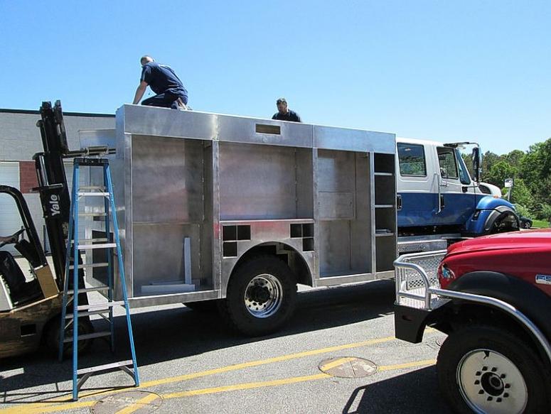

I know you went with super single's on this rig but is that were they stay or is there more work to be done . They look a little to far in on these photo's
This is were they will be, we went with a 102" wide body thus why they are in further, same design as the Washington CT rig, I tried posting the link from Feb. 2011 in the apparatus photos section for the Washington rig but the pictures do not load.

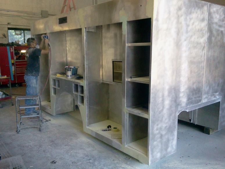

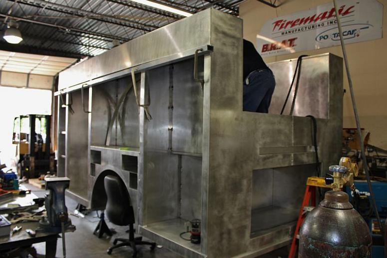

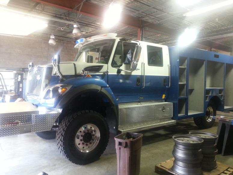

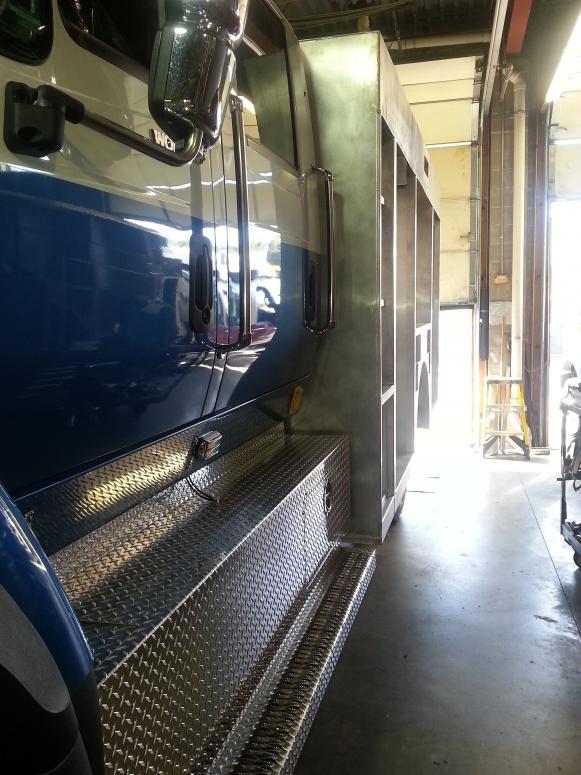

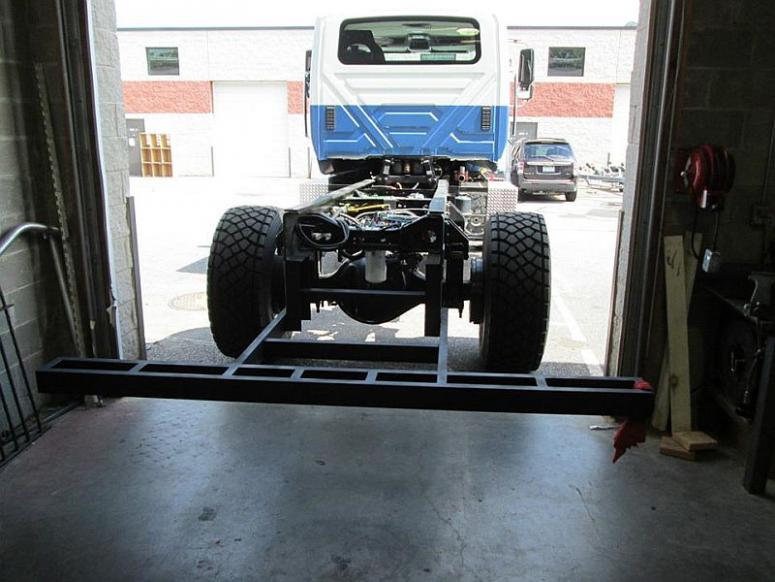

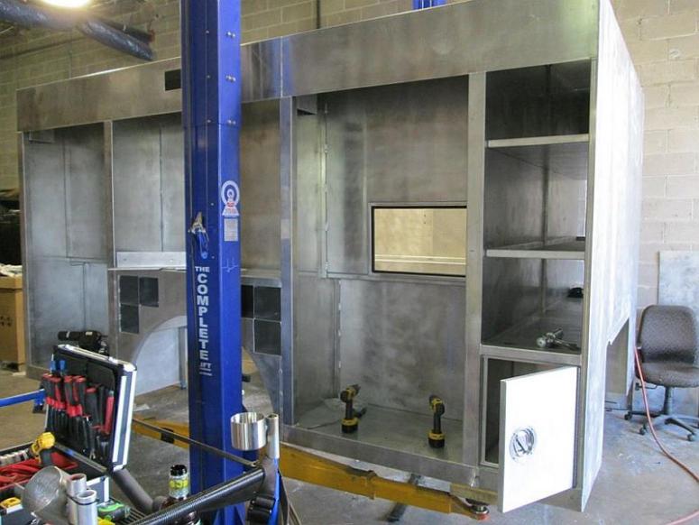

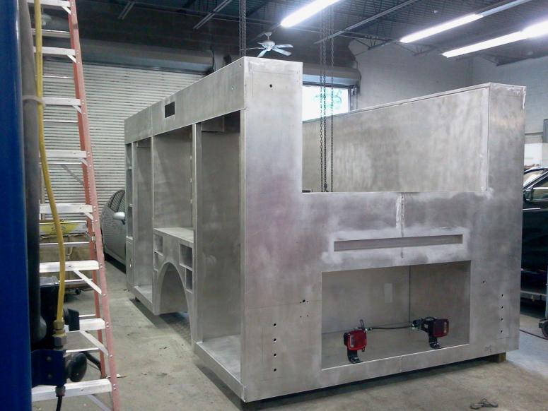

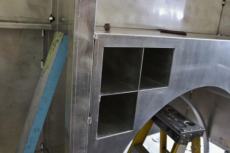

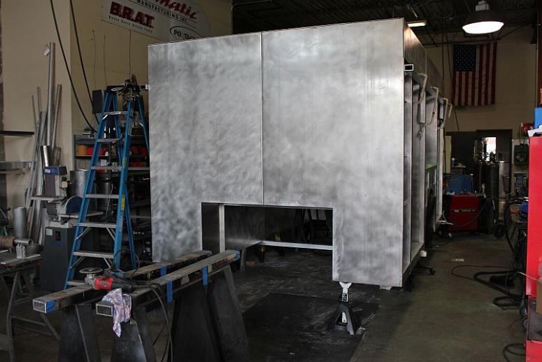

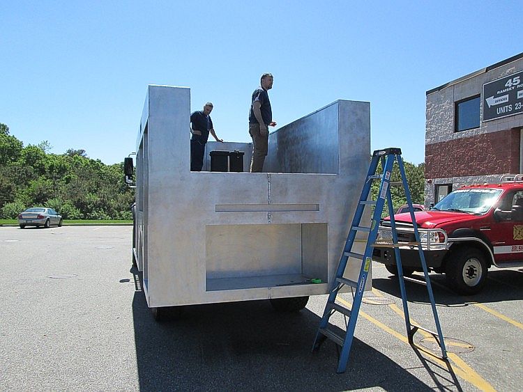

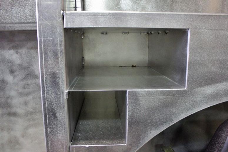

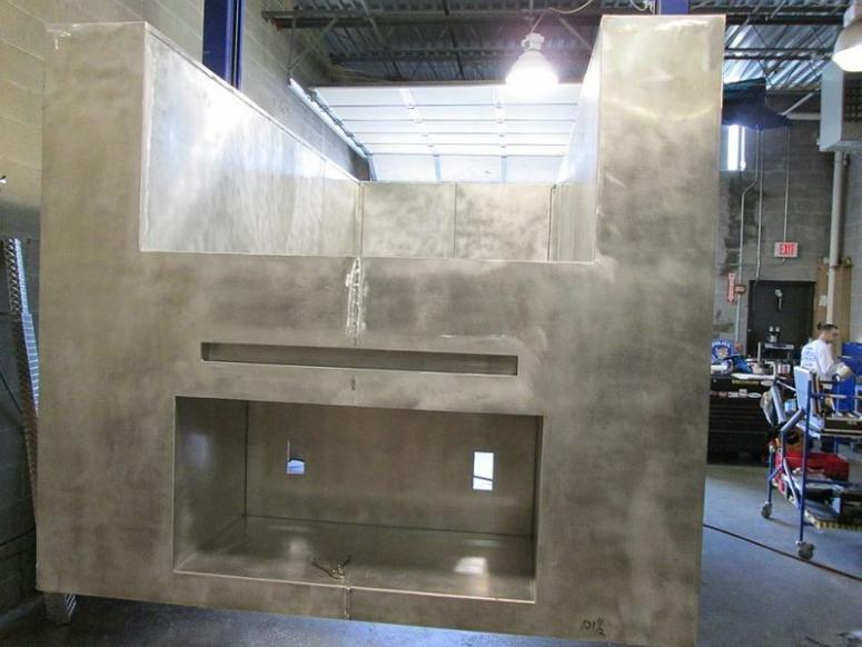

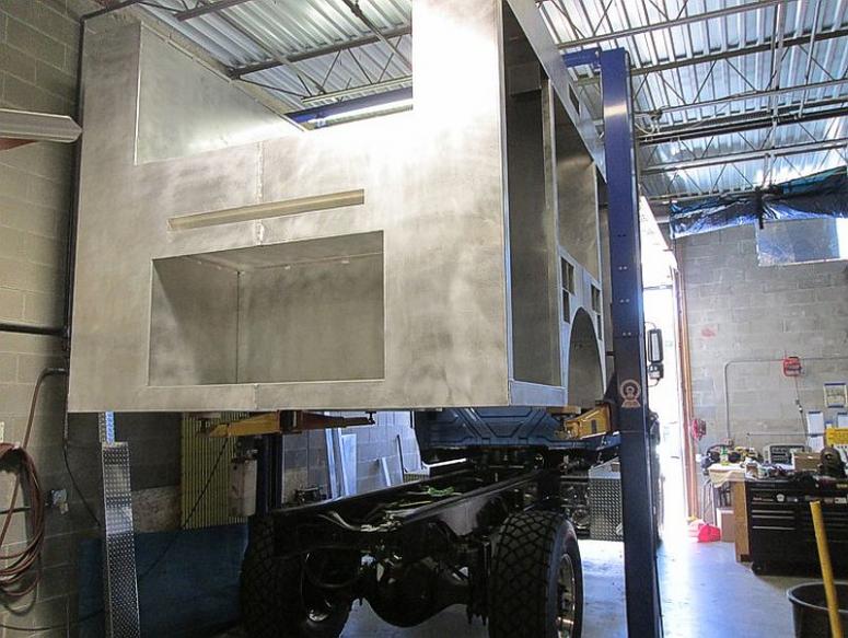

A few from the shop, it went off to paint, frame work at the rear of the chassis to support the body, the cut outs the rear of the body for the tow eyes and sound-off signal 12 light LED traffic advisor and the side of the body showing the lower compartment for storage of foam pails, the access door in the officers compartment to the CAFS valves and plumbing and the 2 1/2" CAFS speed lay, 2 - 2" CAFS speed lay and the upper area which will house dead lay of forestry hose, all speed lays will be in poly trays for ease of packing.
Edited by markmets415

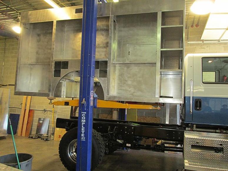

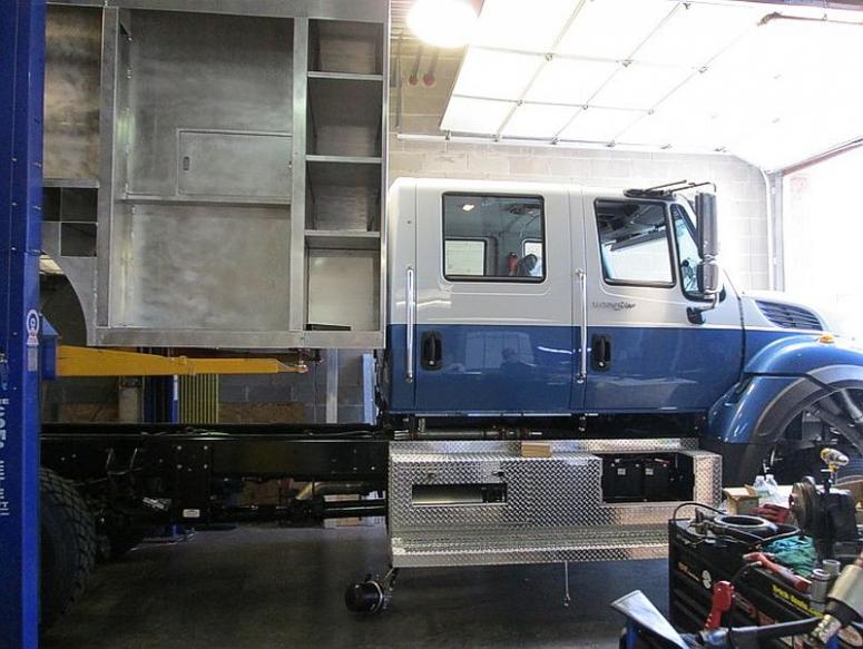

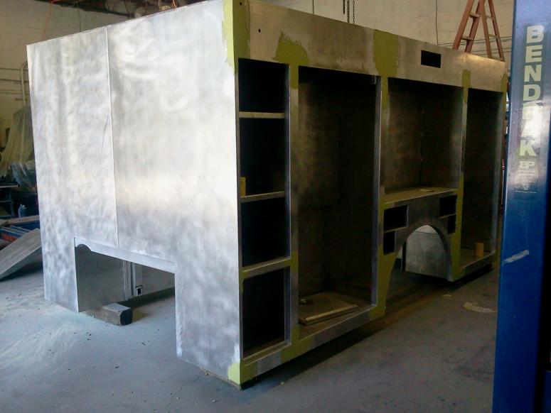

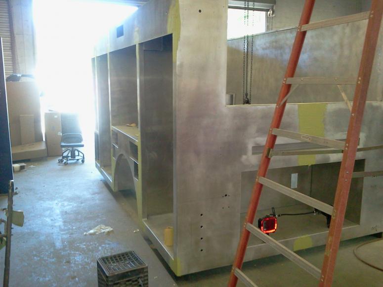

Chassis returned after pump painted, the body has been prepared and paint is online to be completed by early next week so we should see a completely painted Engine by the end of next week the build process should move along rather quickly, as a side note the body was removed and taken off site to the Pierce warranty (Kessel's) paint shop and the chassis was returned to the Firematic shop for the re-install of the pump plumbing and bumper assembly as well as interior cab electronics.

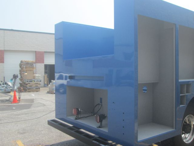

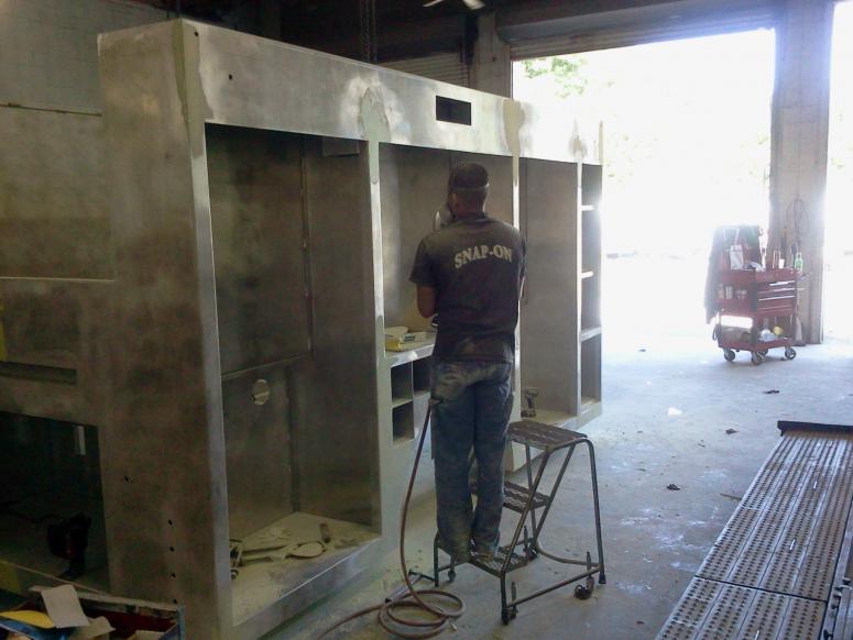

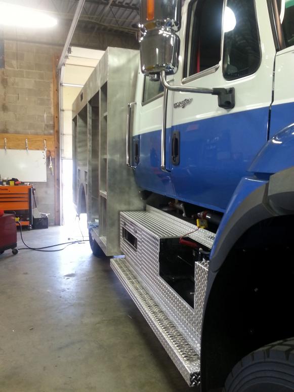

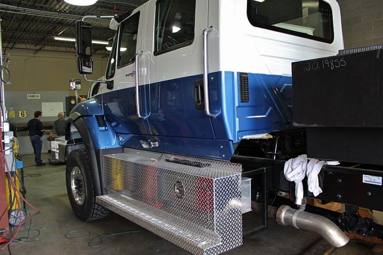

sent from the shop, photos from Kessel's body preparing the body last week for paint which is to start today and the remounting of the newly powder coated front bumper and permanently installed pump plumbing and lighting, we should have a whole painted truck back Friday and hopefully a trip down next week.

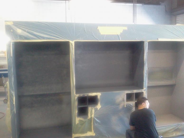

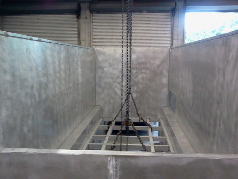

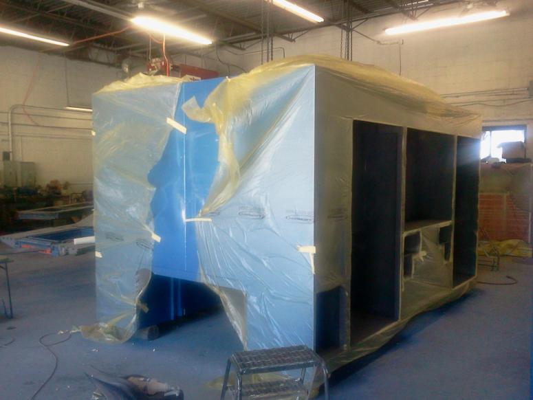

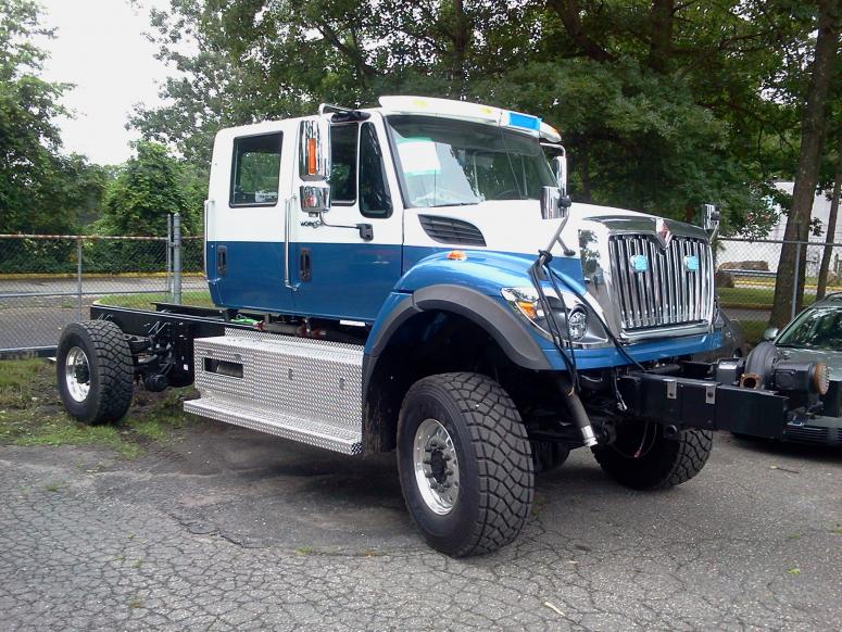

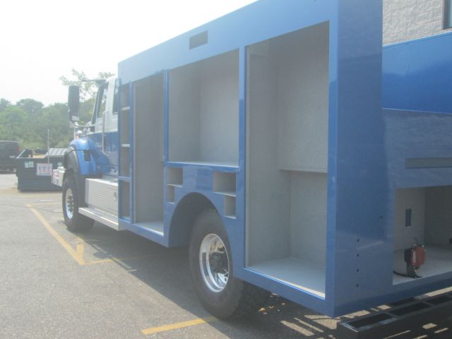

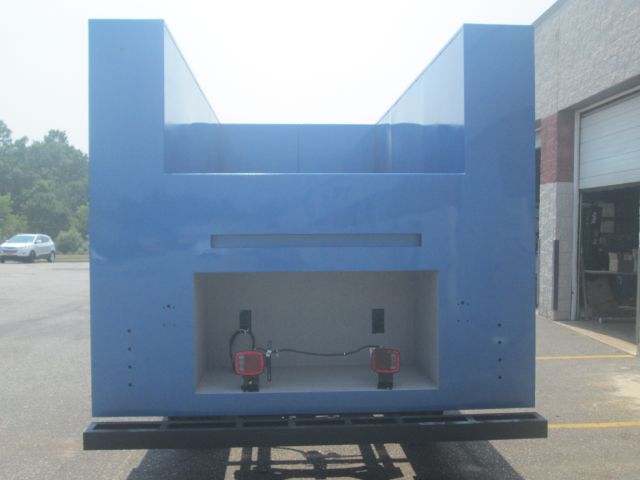

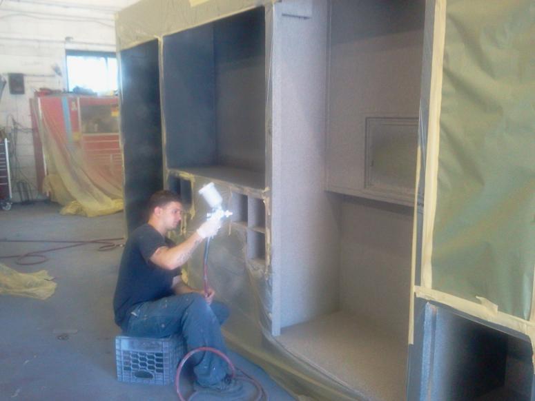

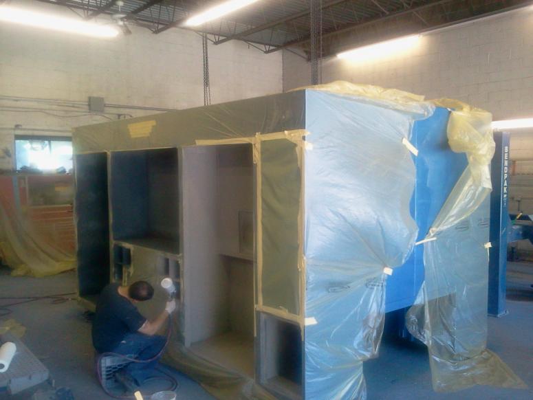

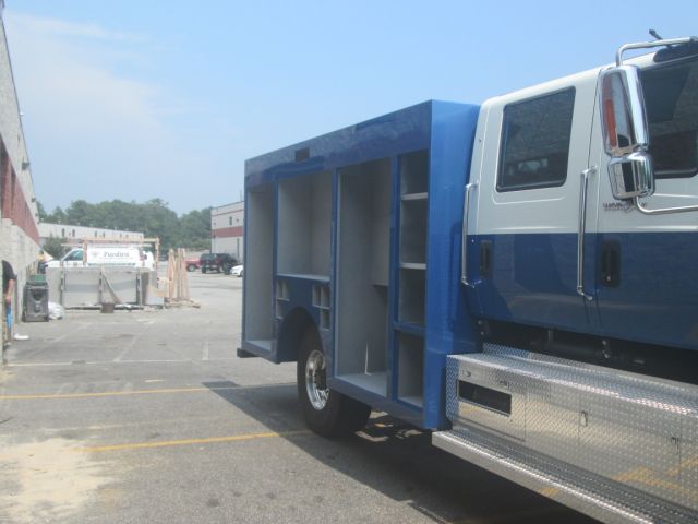

Some more from the paint shop today, body completed and painting the inside of the compartments with the gray splatter type paint and some other random shots they sent, chassis meets body again in the morning so I should have a few more pics to add, we are headed down next Saturday for our next visit.
EmsFirePolice, grumpyff and x4093k like this
The original color is bright regatta blue
