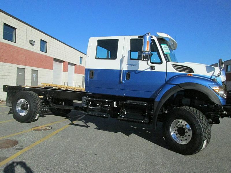

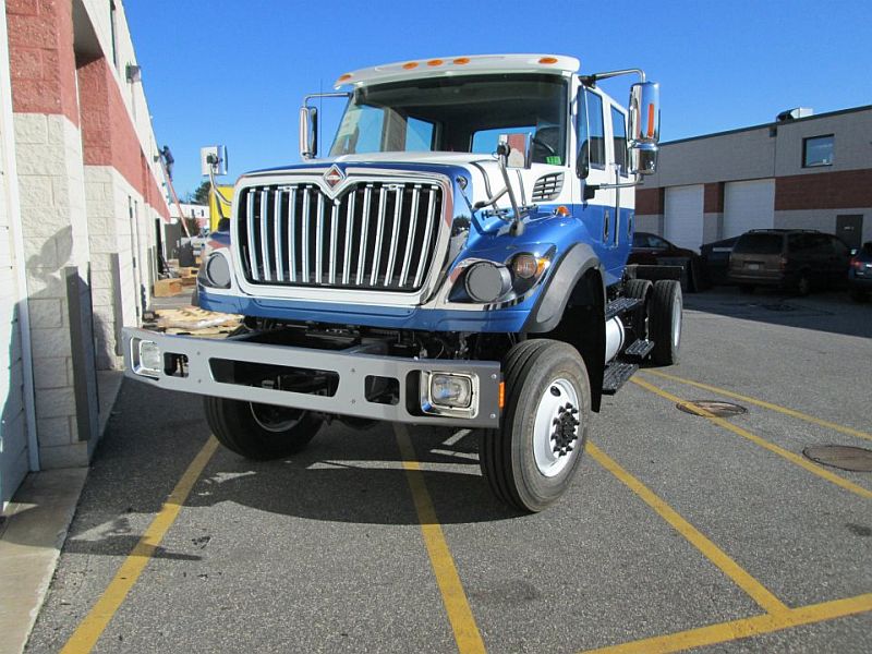

I started a new topic as it appears the old one is now lost. Wassaic's new pumper to replace the 1989 Pierce Dash is under construction at Firematic on LI. Here are some of the specifications regarding the vehicle.

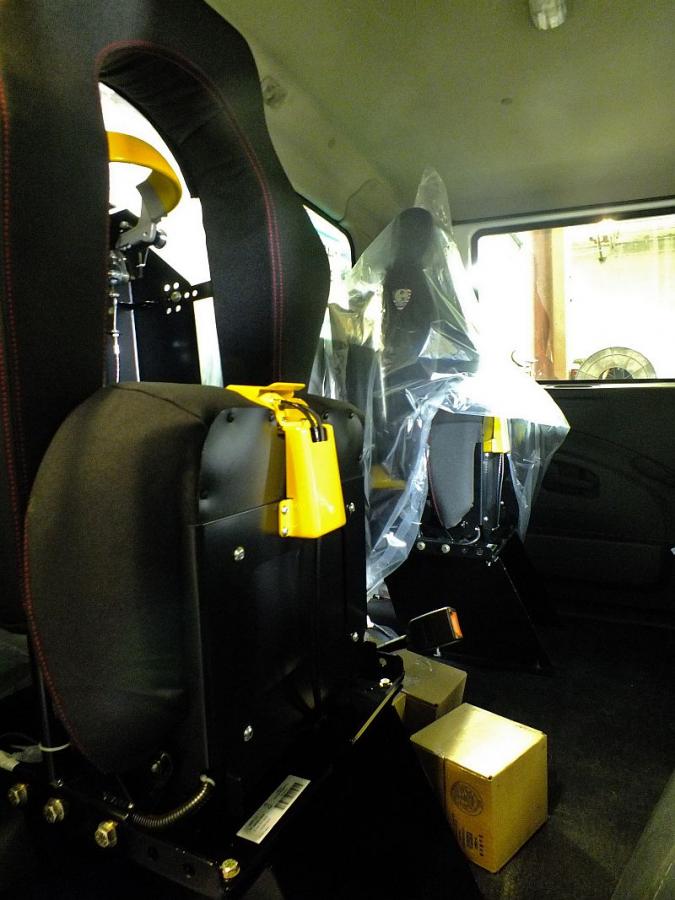

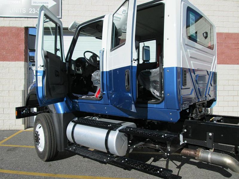

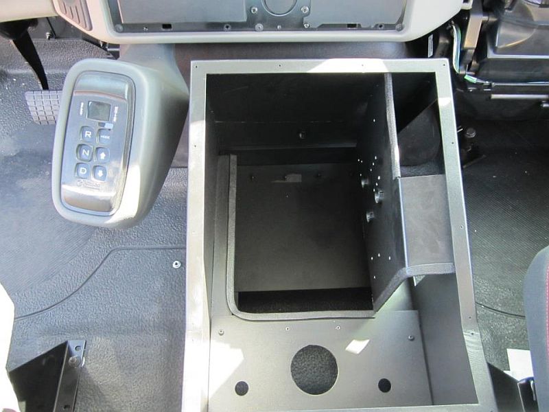

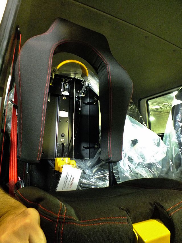

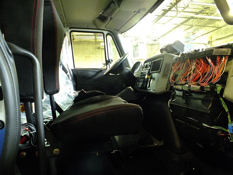

Custom USSC seating at all locations (4) with dual seat belt and SCBA release.

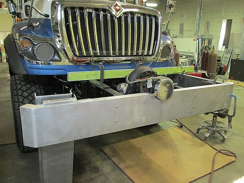

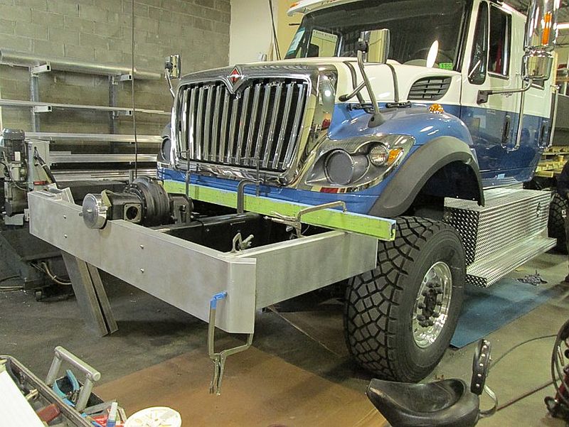

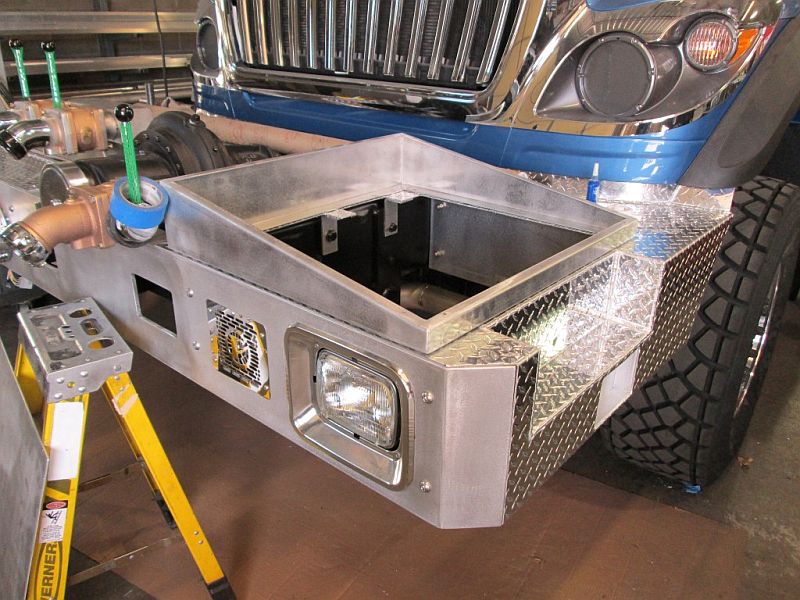

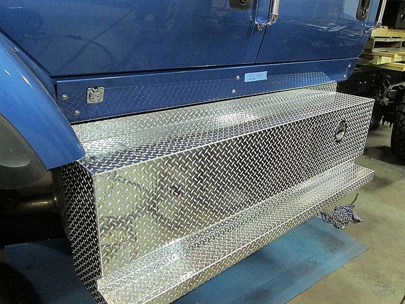

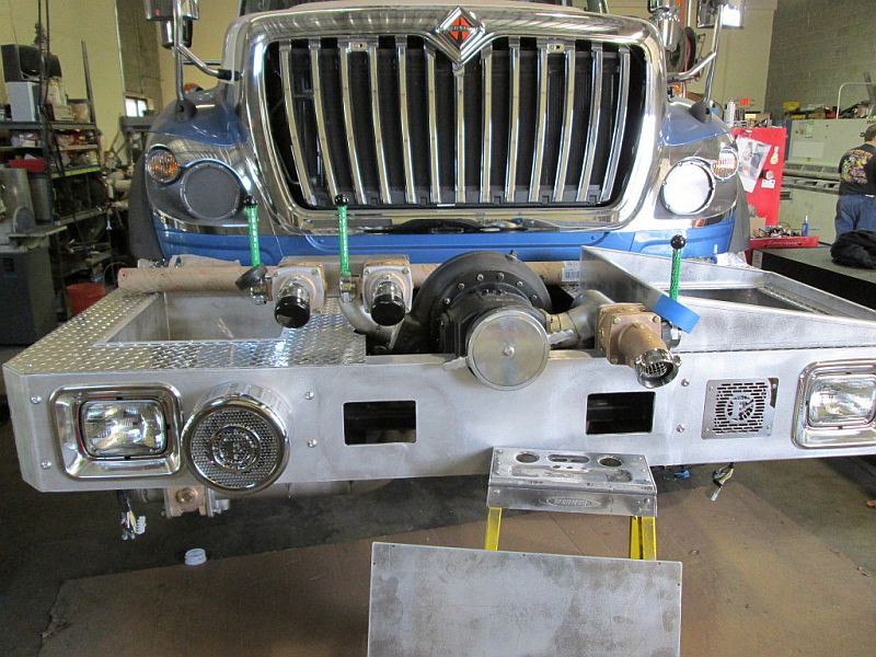

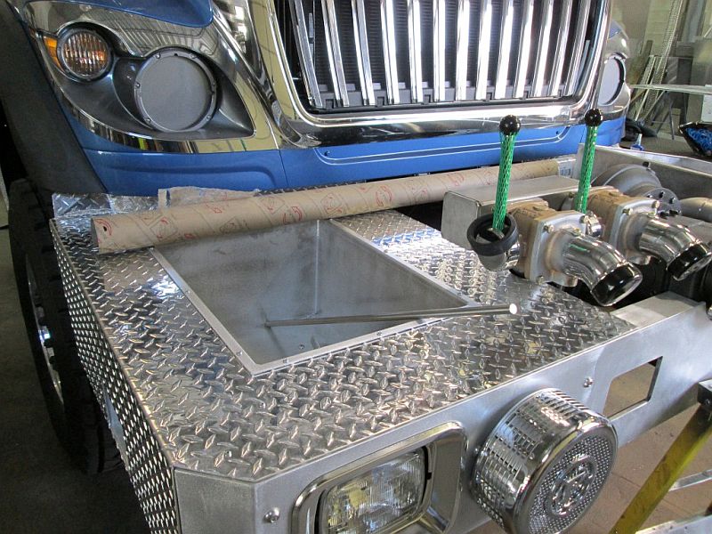

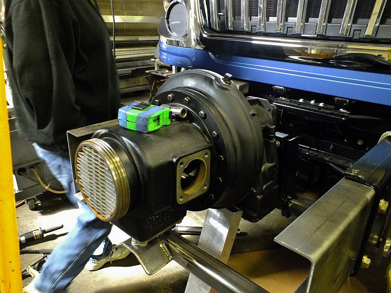

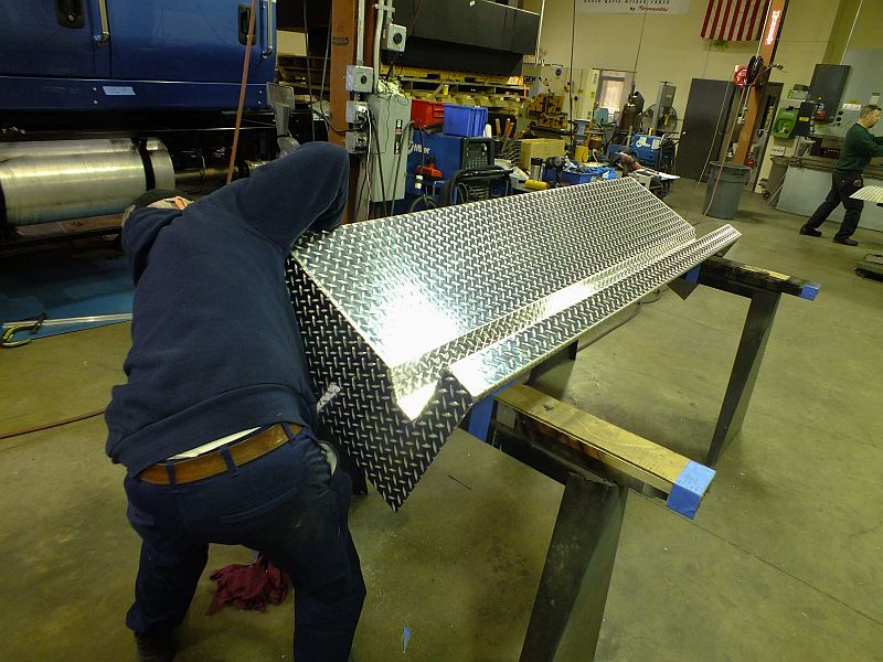

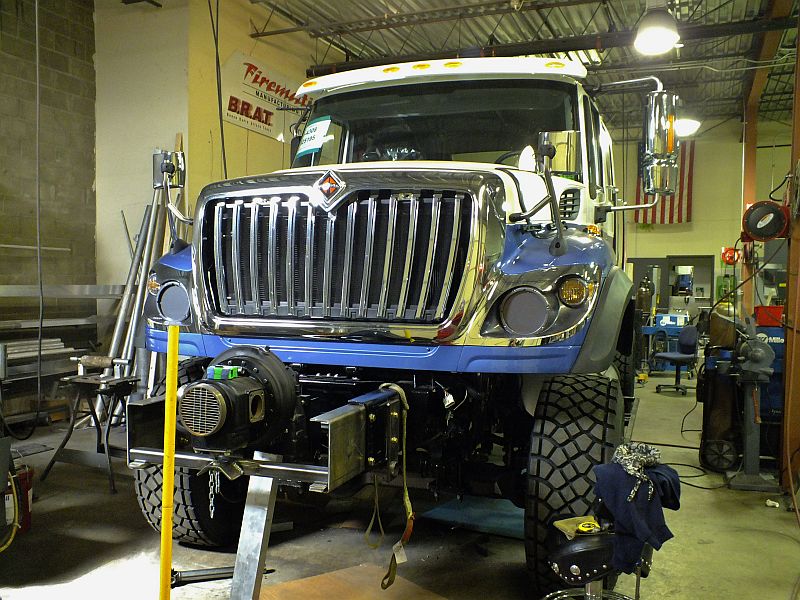

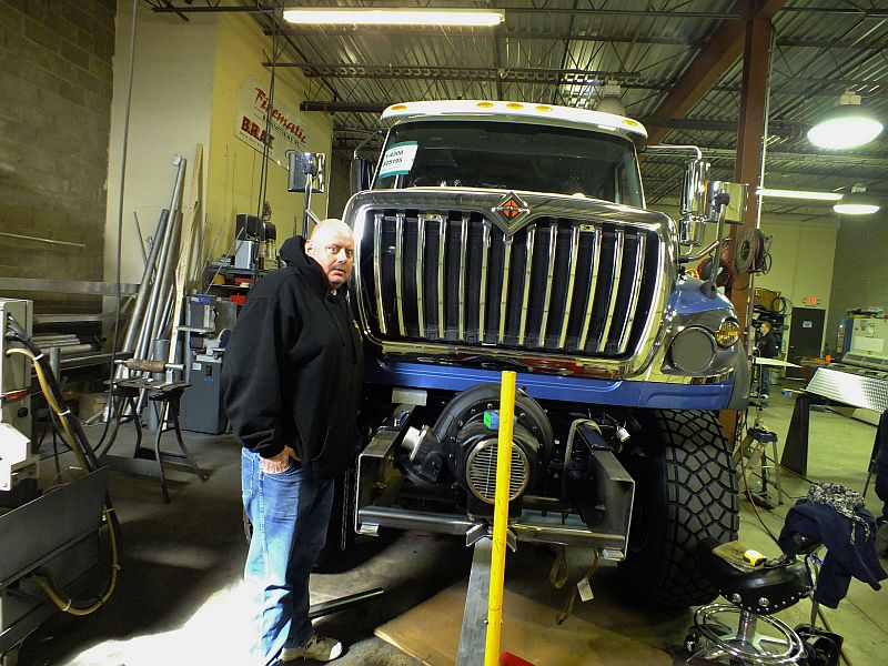

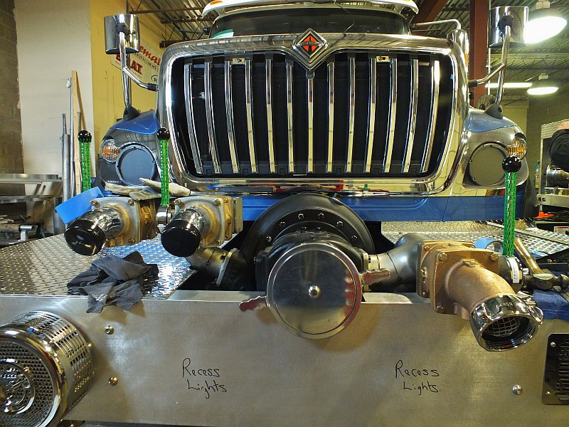

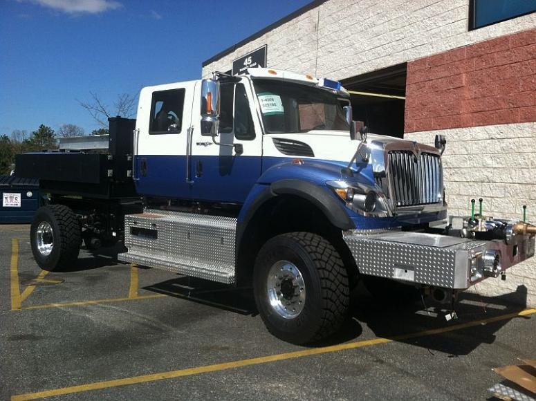

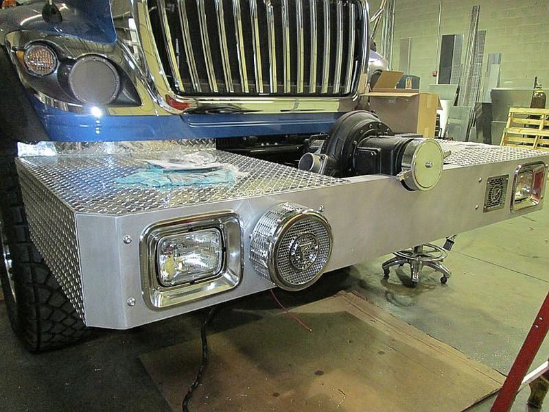

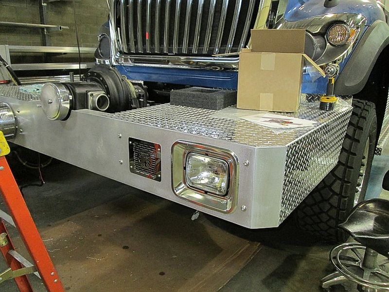

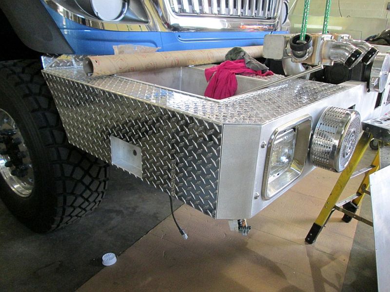

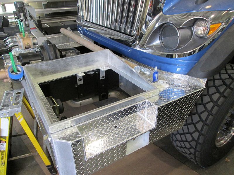

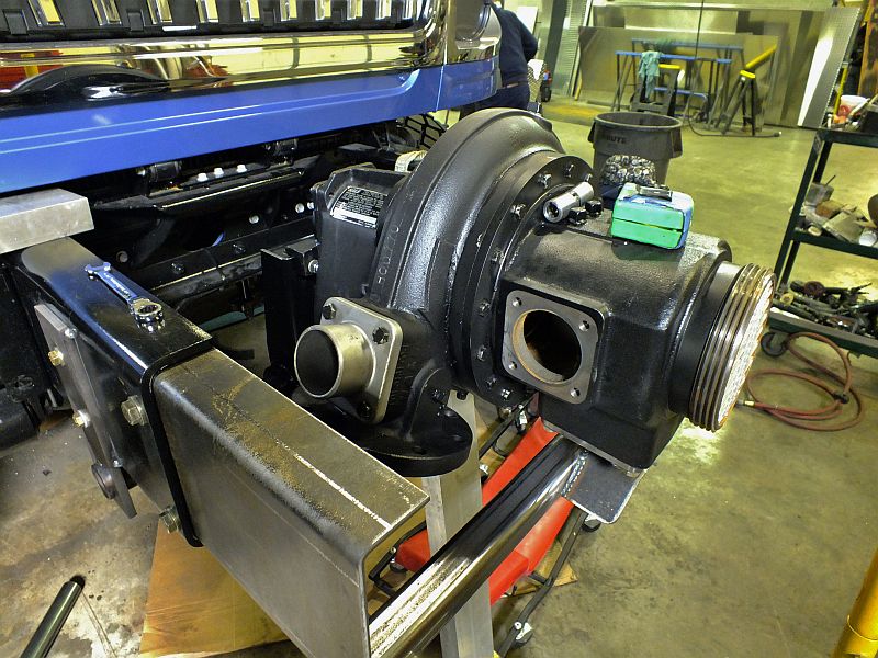

front mounted pump started, steps and bumper area
sfrd18 and EmsFirePolice like this

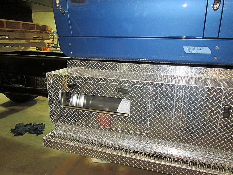

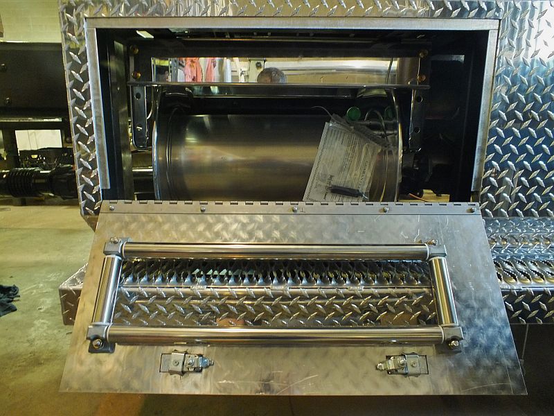

Reel to hold 200' of hard 1" line with CAFS
Edited by markmets415

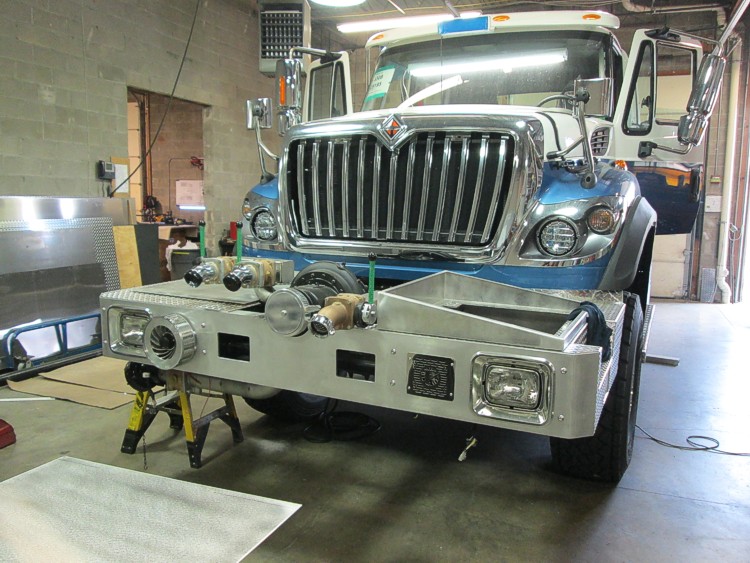

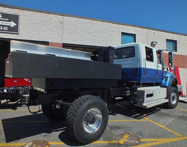

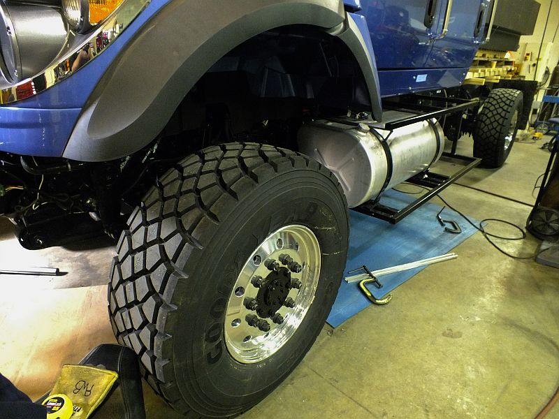

further construction and install of the pump and bumper
EmsFirePolice and sfrd18 like this

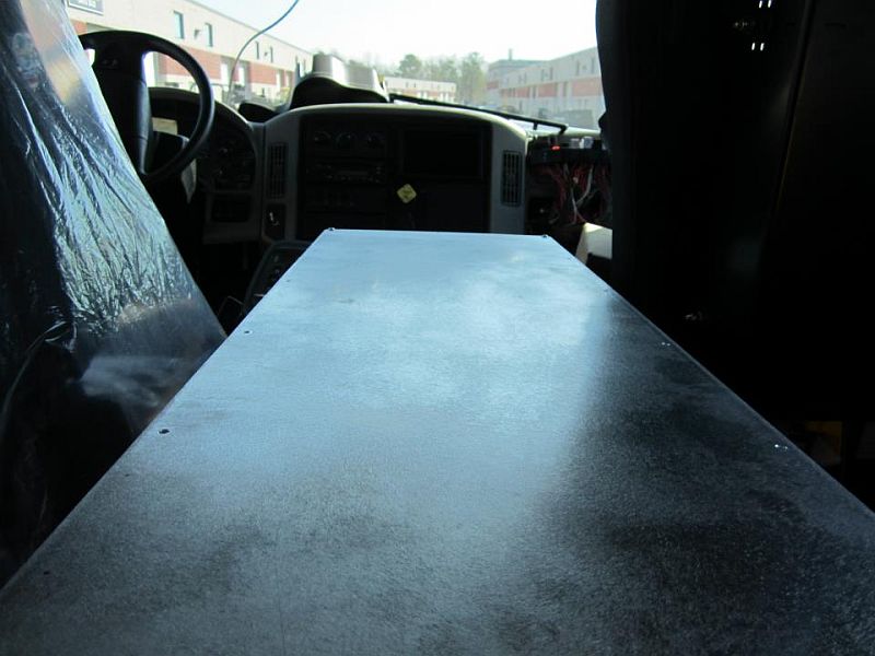

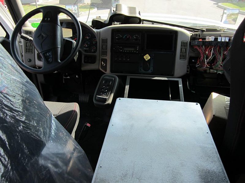

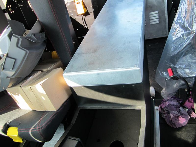

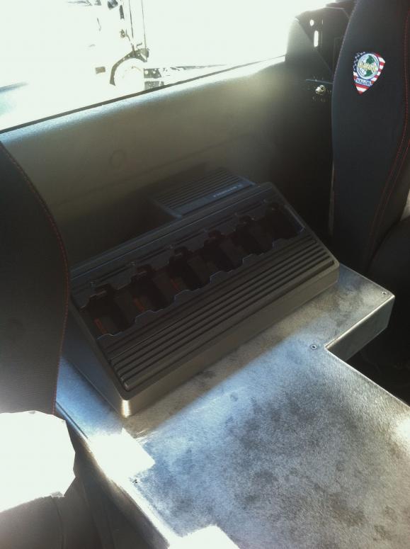

Custom front and the rear table top console being installed, rear area to hold TIC camera and vehicle mounted charger, knox box, flashlights, carbon monoxide and gas monitor, portable radio bank, a 10" flip down monitor for the monitoring of the TIC camera operations, the bottom of the rear console was left open to be able to place gear bags and there will be an area at the rear for storage and also the mounting of the 3000 watt invertor. We are going to the shop next Friday for a visit so I will post some more detailed progress photos.

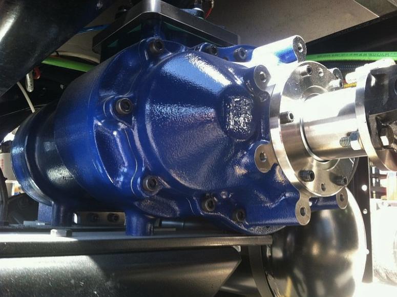

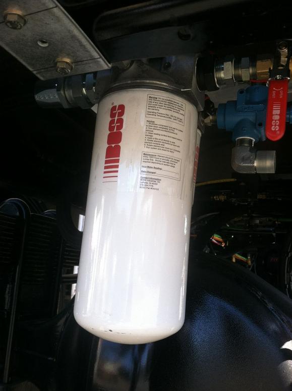

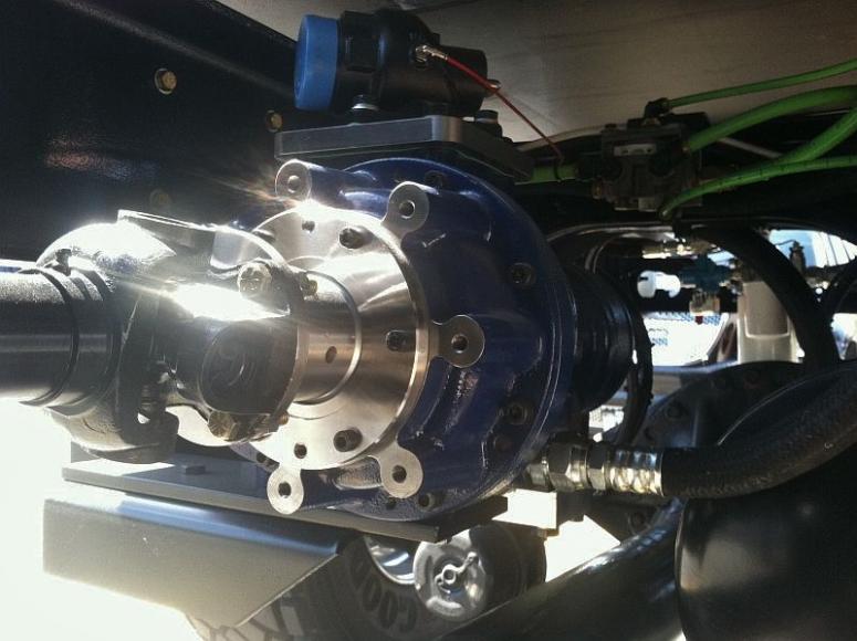

The Boss 200 CFM PTO operated air compressor for the CAFS system

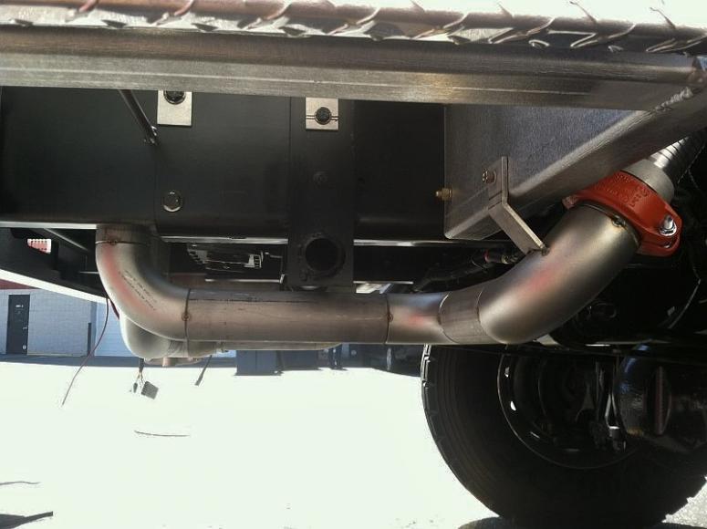

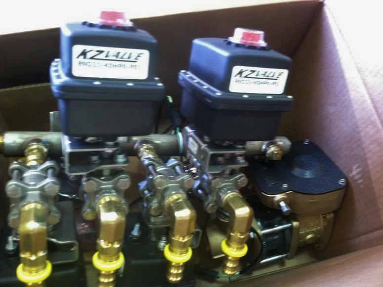

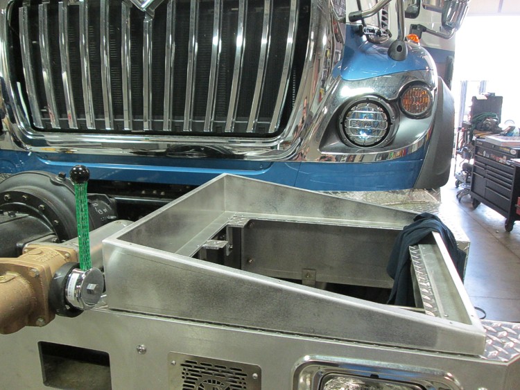

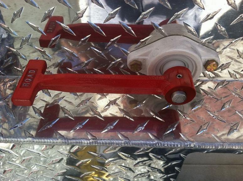

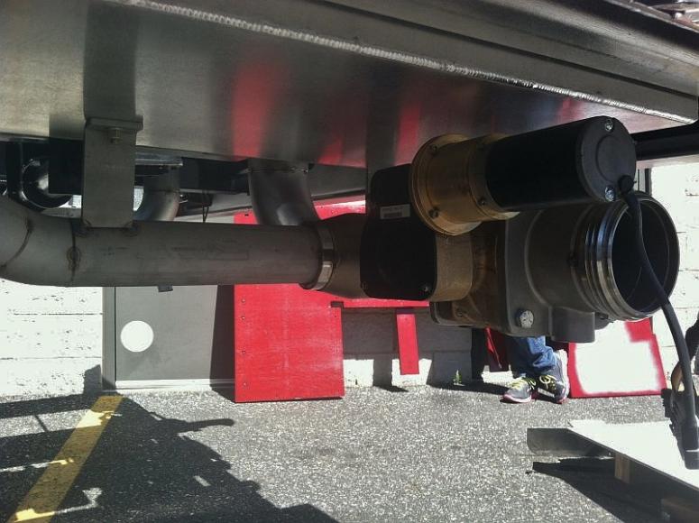

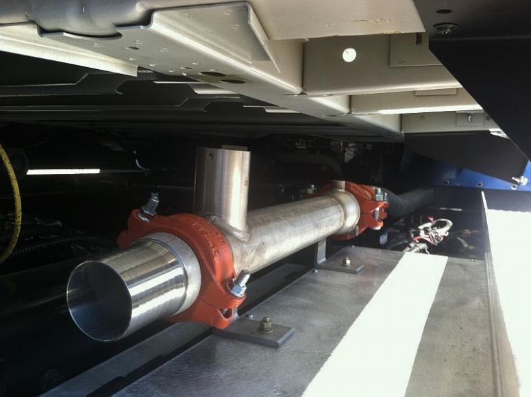

Some of the pump plumbing, 3" tank to pump line, the front 4" electronic discharge with 5" storz adaptor and tank fill line.

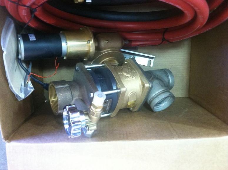

others, 2" and 2 1/2" electronic valves awaiting install, the road to pump transfer level, radio bank in rear cab area, front of poly tank where the CAFS appliance and air controls will be, the air valve appliance and the USSC Valor custom seating label, body should go to paint at the end of next week and a visit to follow, it's coming together rather nicely.

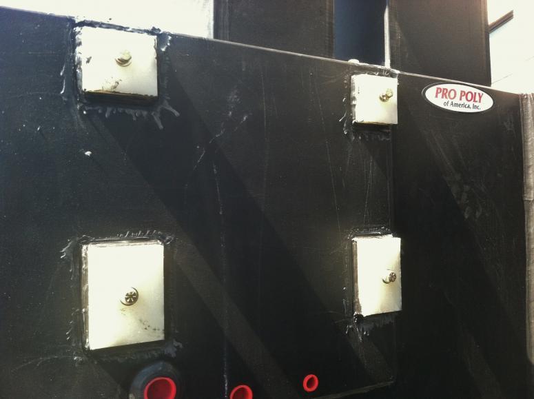

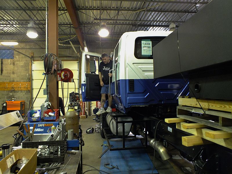

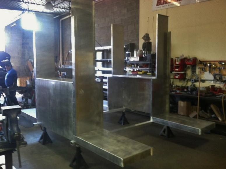

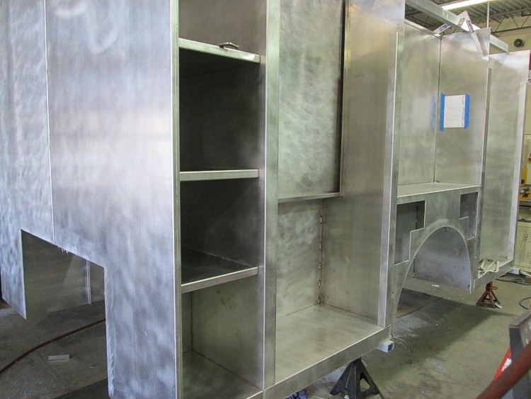

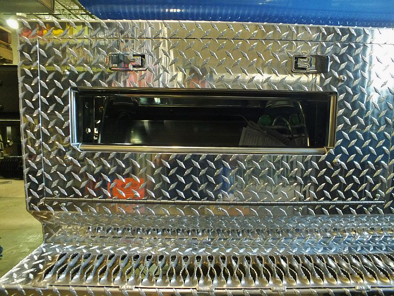

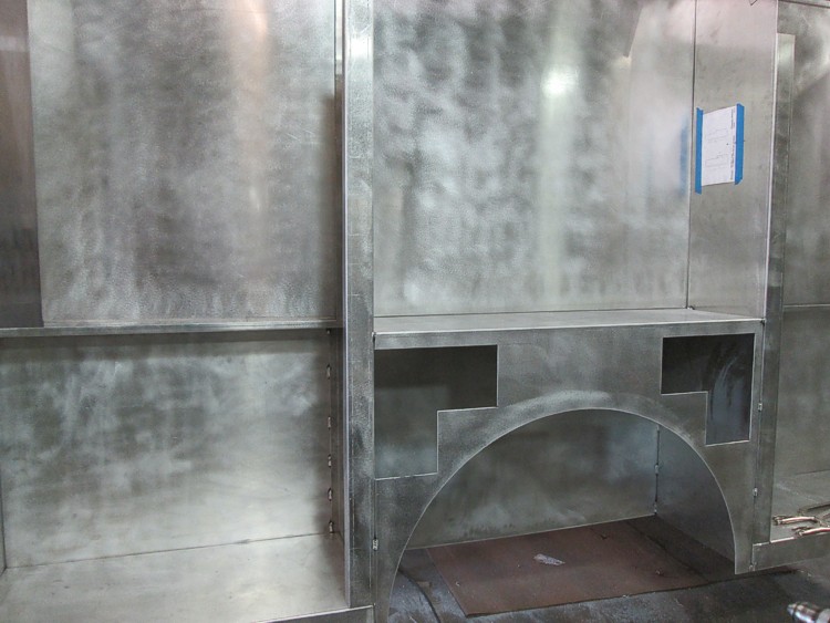

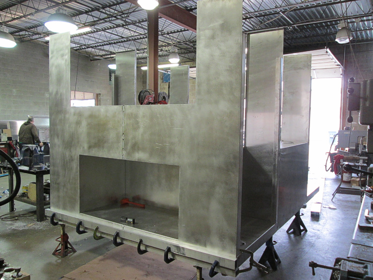

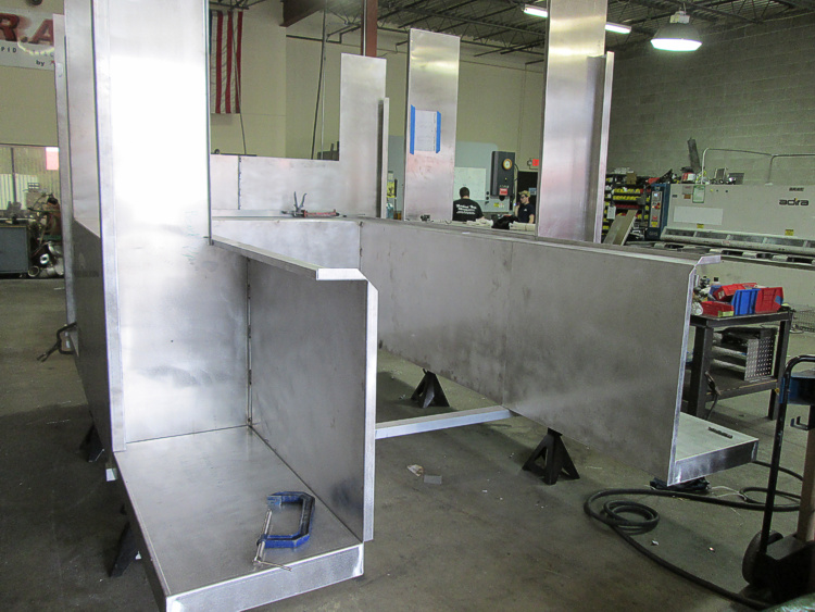

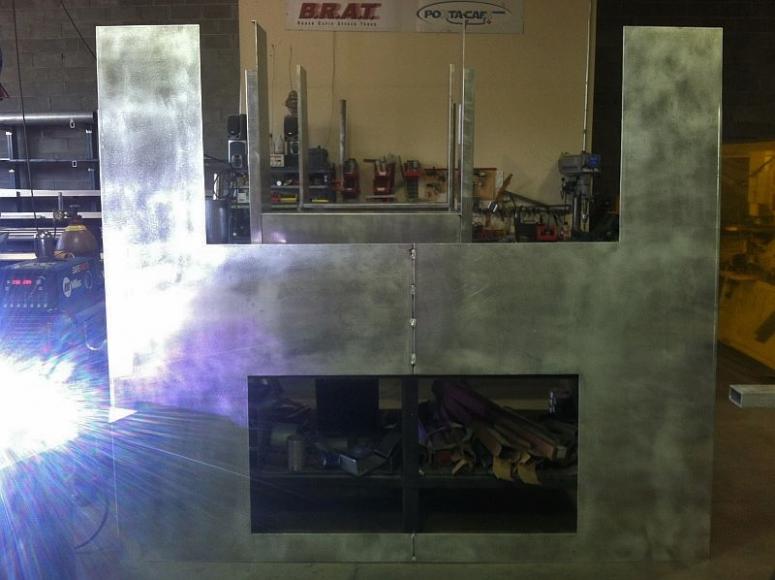

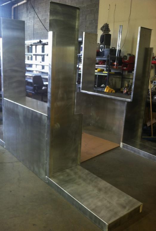

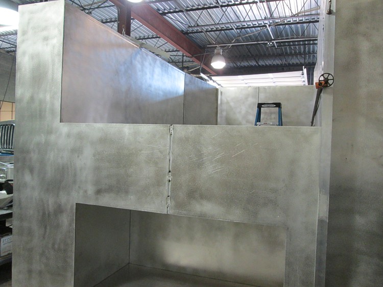

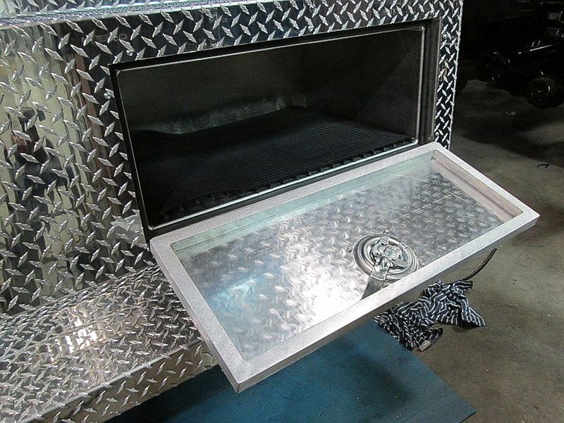

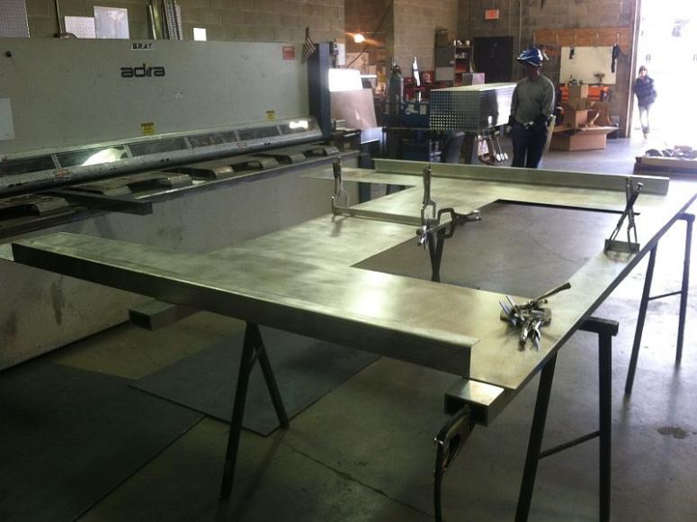

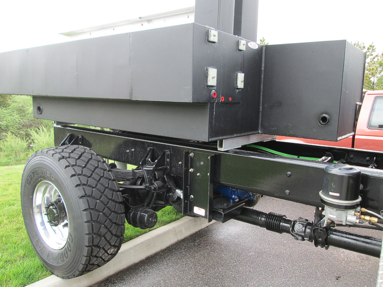

a few added shots sent from the shop showing the front cutout of the booster tank where the CAFS manifold and speedlay plumbing will be as well as some shots of the body sheets coming together.
EmsFirePolice, JetPhoto and sfrd18 like this

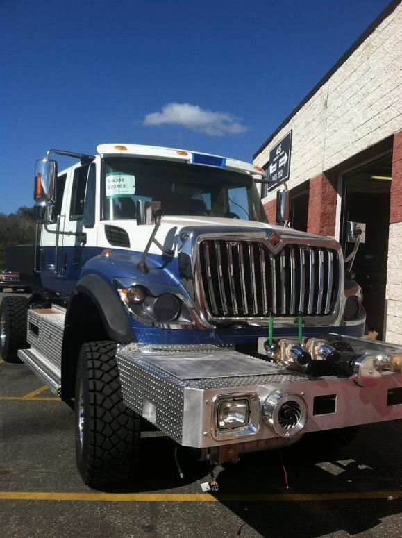

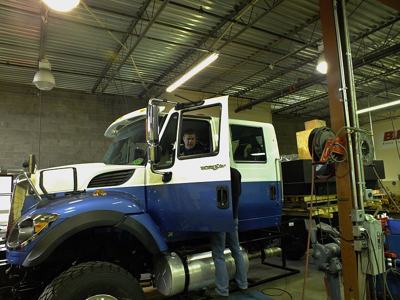

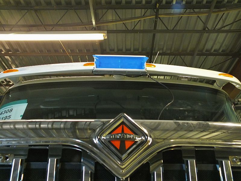

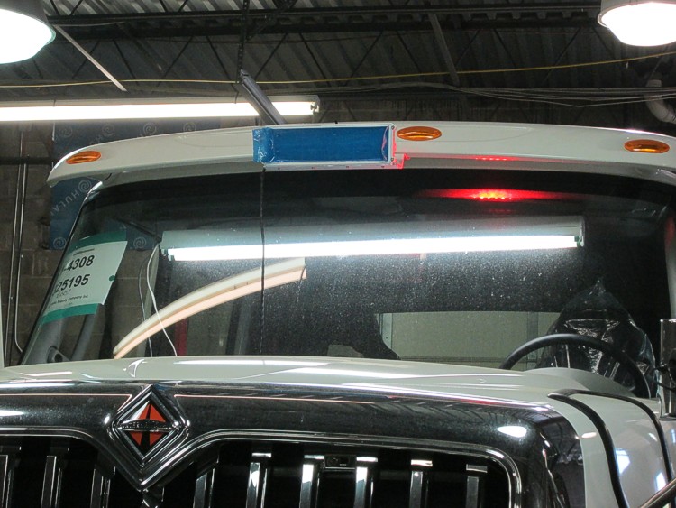

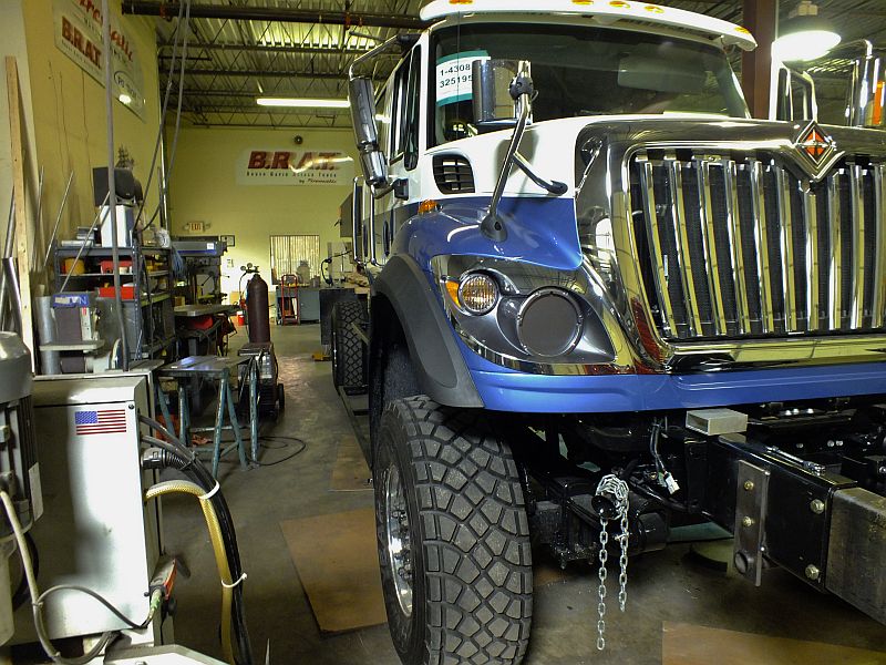

a few sent from the shop today, the inner light bar installed, no it's not that 6' light the tech was using that you can see inside the cab, the PIAA off road lights are installed in the old headlight housing for extra lighting during night time ops as well as aiding in the poorly lit dirt roads that we encounter frequently and a few of the body showing the speedlay, foam storage areas at the front of the body and the cutouts for the spare bottles and other items to be stored there, as well as the hose bed and custom area that will hold the ladders, tools and suction.

Is it going to have a light bar on top of the cab or just inside the windshield?

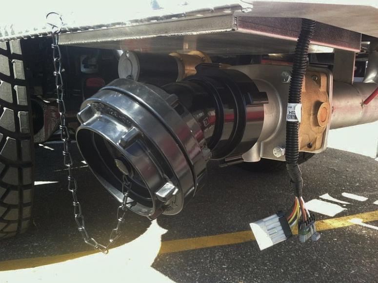

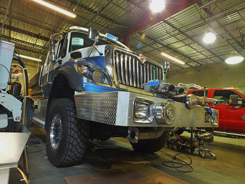

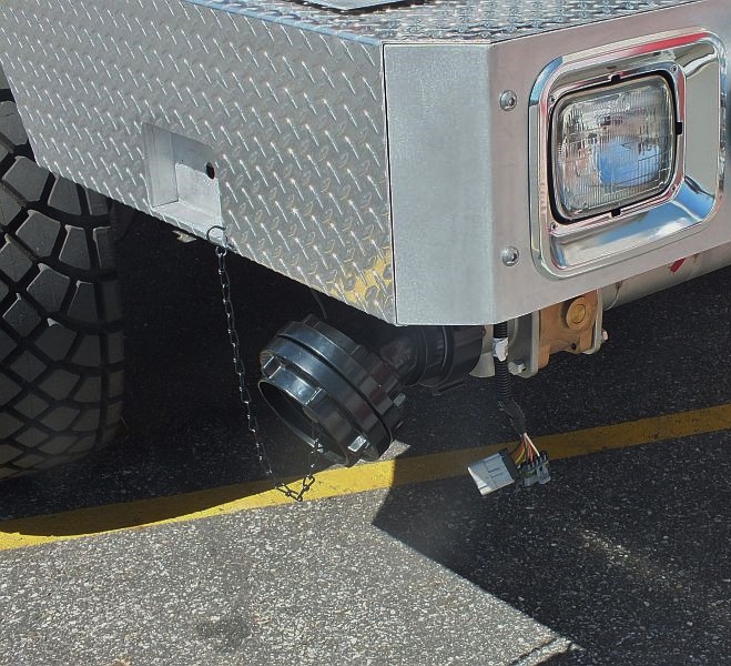

I am an EMT not a fireman, but it would seem that the 5" inlet/discharge under the extended front bumper would get damaged easily. Was there no option for placing it in the bumper itself? Just curious..
markmets415 and JetPhoto like this
Just the inner light bar, the 2013 cab is now 4" higher which created a height problem for us with the light bar on top of the cab, the picture of the inner light isn't really very good, we have added lights on the sides as well as the mirrors to help cover the intersections. See the links of the lights being used.

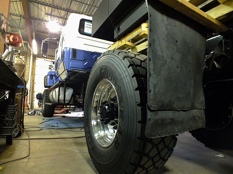

This is the fourth front mount unit they have built and all have the same area for the large diameter discharge and to date there hasn't been a problem, the front mount design is subject to more damage than a mid-ship or top mount solely based on it's location at the front of the vehicle, it does look lower than it will be, I had placed the adaptor on it to actually check to see how far it was going to stick out passed the side of the bumper, it can be turned upward to gain some more clearance but thanks for the valid question, it's something to pass on to the shop when we visit again. I will also get a better picture from the ground as well to show the clearance at the next visit.
